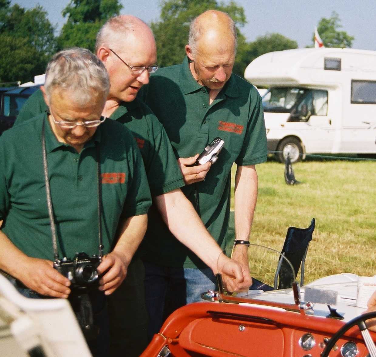

I suppose it depends on how one interprets "Factory Original"; does that mean what might have been used on a Works Competition car (as illustrated in the eBay listing), or does that mean what might have been offered "to the public"? Here's a shot of the latter, what presumably is what one would've gotten by ordering from his/her Triumph dealer back in the day (photo from a TR Register UK Forum post):

Cool photo, Andy !!
Any idea who those people are? Looks like Kas on the right, to me. The others look familiar, but I'm terrible with faces and can't place them.
An interesting design and nice that it uses the original (early cars) attachment points.

"Kas" was my first thought as well; alas, the photo wasn't identified as to who those folks were. And I agree with you about any comments Piggott or most other "British" authors might make. They'd have been much more likely to say "perspex"! :D

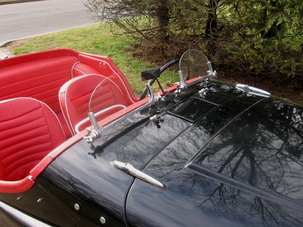

Here's a pair of aftermarket aeroscreens I bought many years ago from Victoria British.
Hey Art did those fit in the holes for earlier cars?
No, they came with their own pedestals that have to be screwed into the scuttle. The earlier bodies have four weld nuts in the scuttle for mounting a special bracket for the aeroscreens to attach onto. I originally had an early body and was going to make those brackets, but since my early body was rotted very badly, when a decent post 60k body showed up very cheap, I opted to go that route. Now i have a post 60k car with a TS23,xxx commission number. No concours judging for my car! :playful:
In the top photo, that's Bill Piggott on the left and it certainly looks like Kas on the right. The white car looks to be TS2, the first RHD production TR2, fitted with original factory aeroscreens made by Brooklands. These had legs that matched the factory fixing bolts on the scuttle, discontinued at TS32833. They also had a channel on the underside to take a cut section of a lower windscreen seal.
Factory aeroscreens always had double thickness laminated glass in a high "cupcake" shape whereas the glass is lower in the Brooklands universal fitment aeroscreens in Art's photo.
