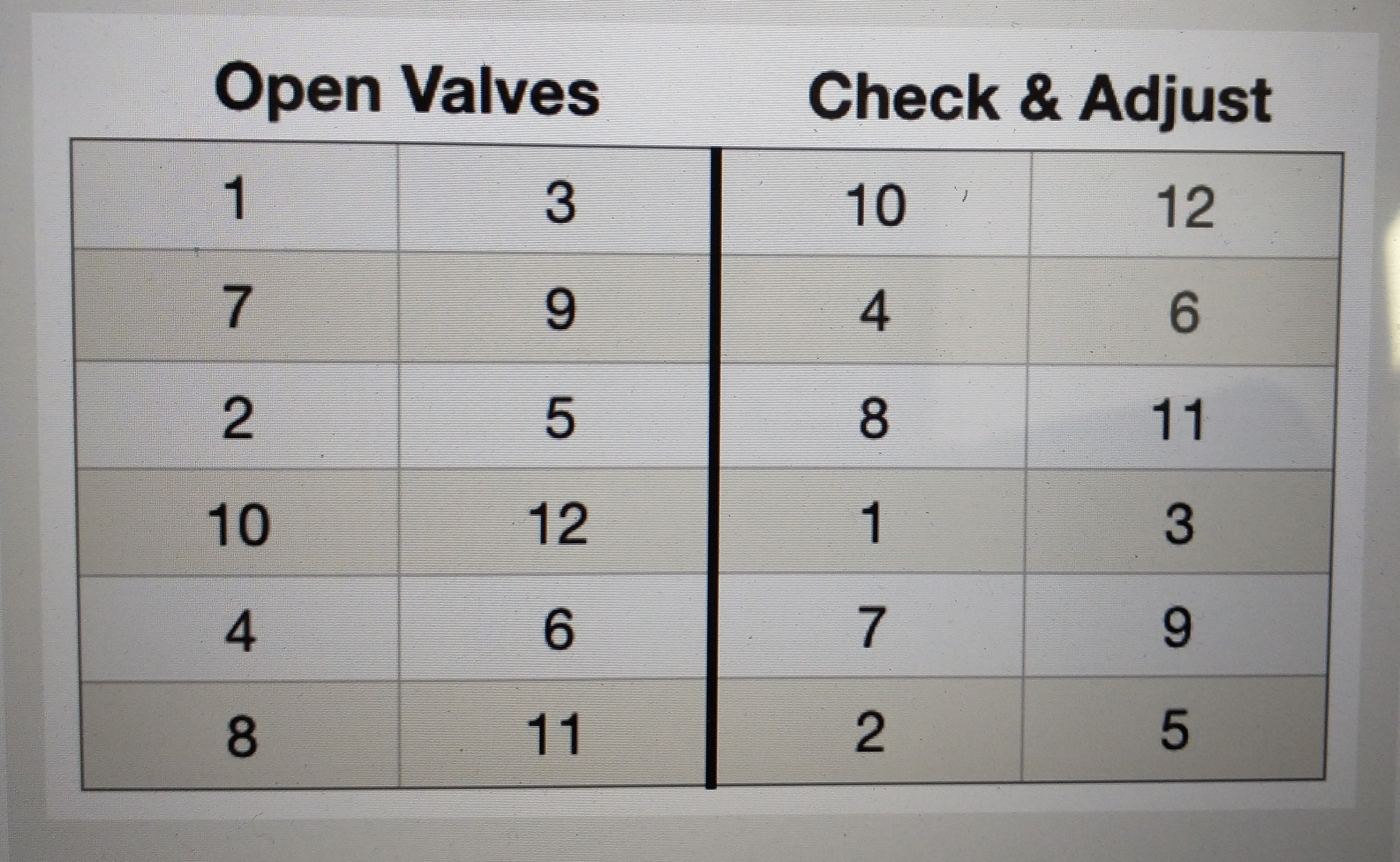

Is this order ok to use?
I put the car in 3rd gear and put one hand on the top of the front tire and the second hand on the windshield post ..... then push with one hand and pull with the other ...... to roll the car forward ...... using the above sequence. Spark plugs out of course. It's very easy this way.
Thank you. That's what I did. Easy Peasy. I used the chart above so you can adjust two valves at a time.
