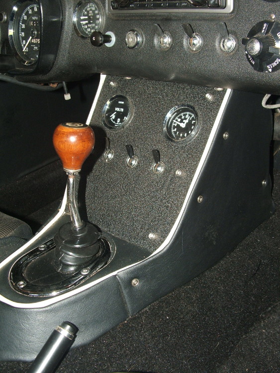

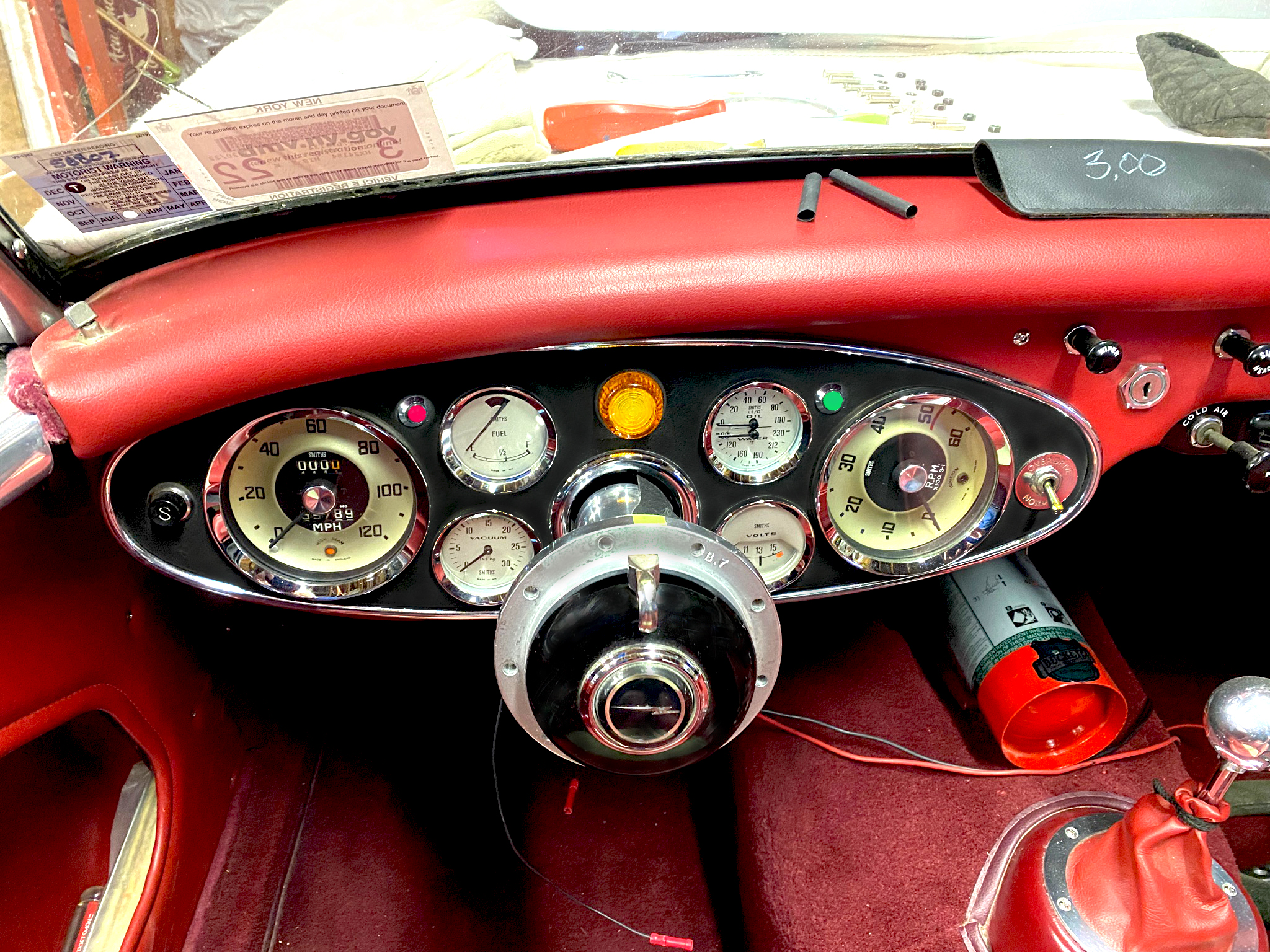

My interest in this topic is intellectual as I have no plans to add an ammeter to my 100. As I think I said earlier in the string, later Healeys are better laid out to add additional instruents whereas the dash of 100--with its graceful iteration of the car's side profile--has little room for extra instrumentation (unless hung underneath). I do have a voltmeter installed on the right side in front of the passenger and I feel it gives me enough information re the real-time condition of my electrical system.
