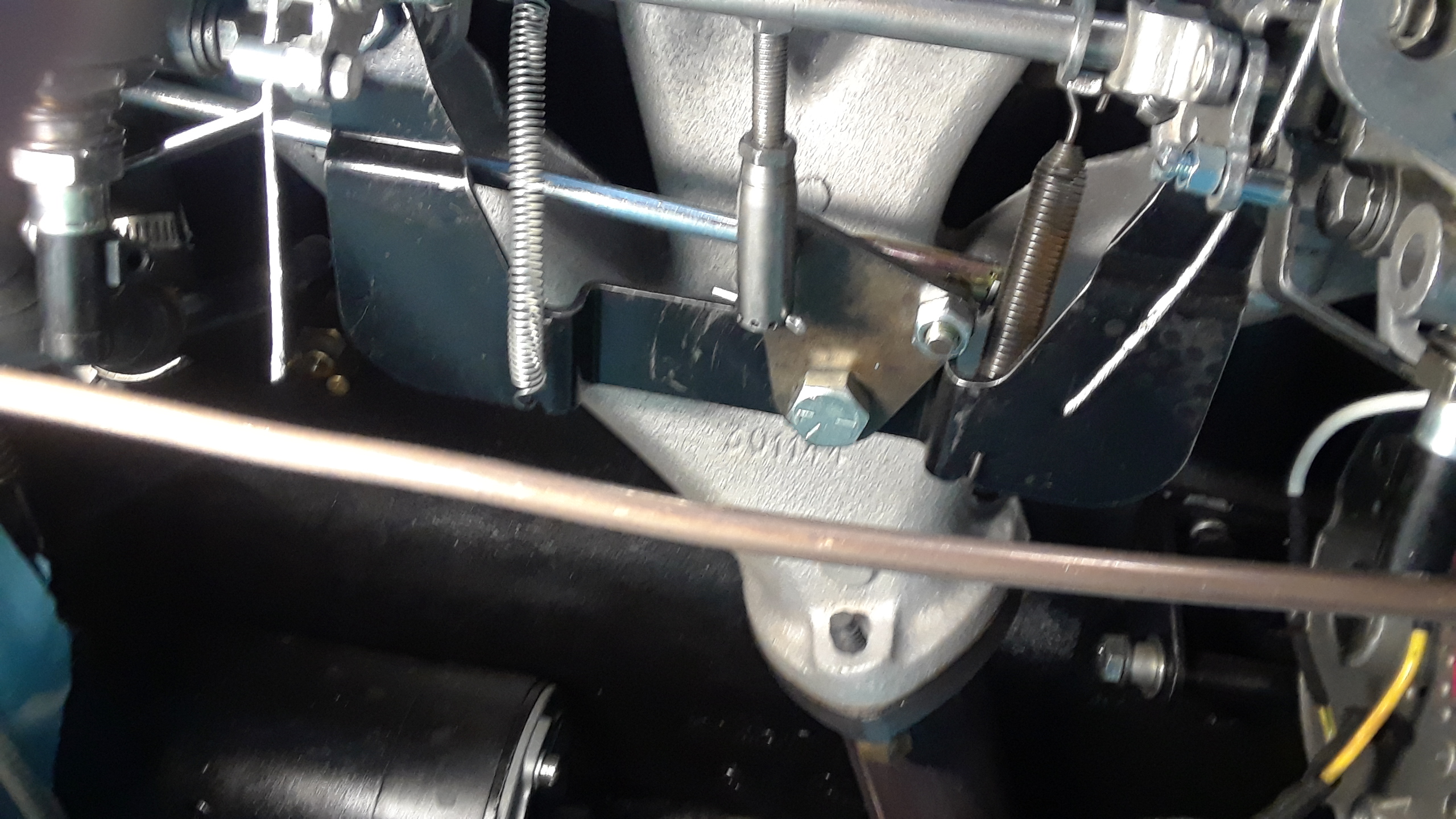

Yes that spring is attached. As I work the throttle manually near the left/rear carburetor, I see absolutely no play at the linkage. The shafts rest tightly each time I release the accelerator shaft. There is some slop where vertical shaft meets the throttle linkages but it seems natural, and it’s not ever sticking at the throttle, and there’s no movement after the accelerator is released. Baffling unless there’s something invisible happening.
Your comment about the play with the verticle linkage is just the thing I found . That can be overcome with tighter springs at the carbs. Referring to the 2 springs in the pic.
Charley

I had a similar sticking and found what cjd described,lateral play in the shafts caused by wear on the carb body where the throttle stop wears and wear on the throttle stop side .This was not addressed when rebuilder fit new shafts.
I filed the carbs body shaft hole thrust face true,measured the gap,and fit a small shim by removing some material from the throttle stop side,also worn , to pull shafts rearward to center,with minimal clearance for free movement.
The correct location of shaft holes when rebuilding would be better but this worked for me.
I think heavier springs will just accelerate wear.
