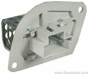

Dale, it sounds like the blower resistor is the likely culprit. Should be a painless fix, and the resistor should be available at any good parts house, if such exists on the island. The resistor controls the three lower speeds, and on high it's bypassed completely. Just the fact that the motor works normally on high indicates <u>it's</u> OK.

Dale, the resistor should be a block plugged into the heater plenum, behind the glove box, possibly held down by a couple of screws. It should have a three wire connector plugged into it. (Maybe 4 wire, I'm not certain.)
Jeff
