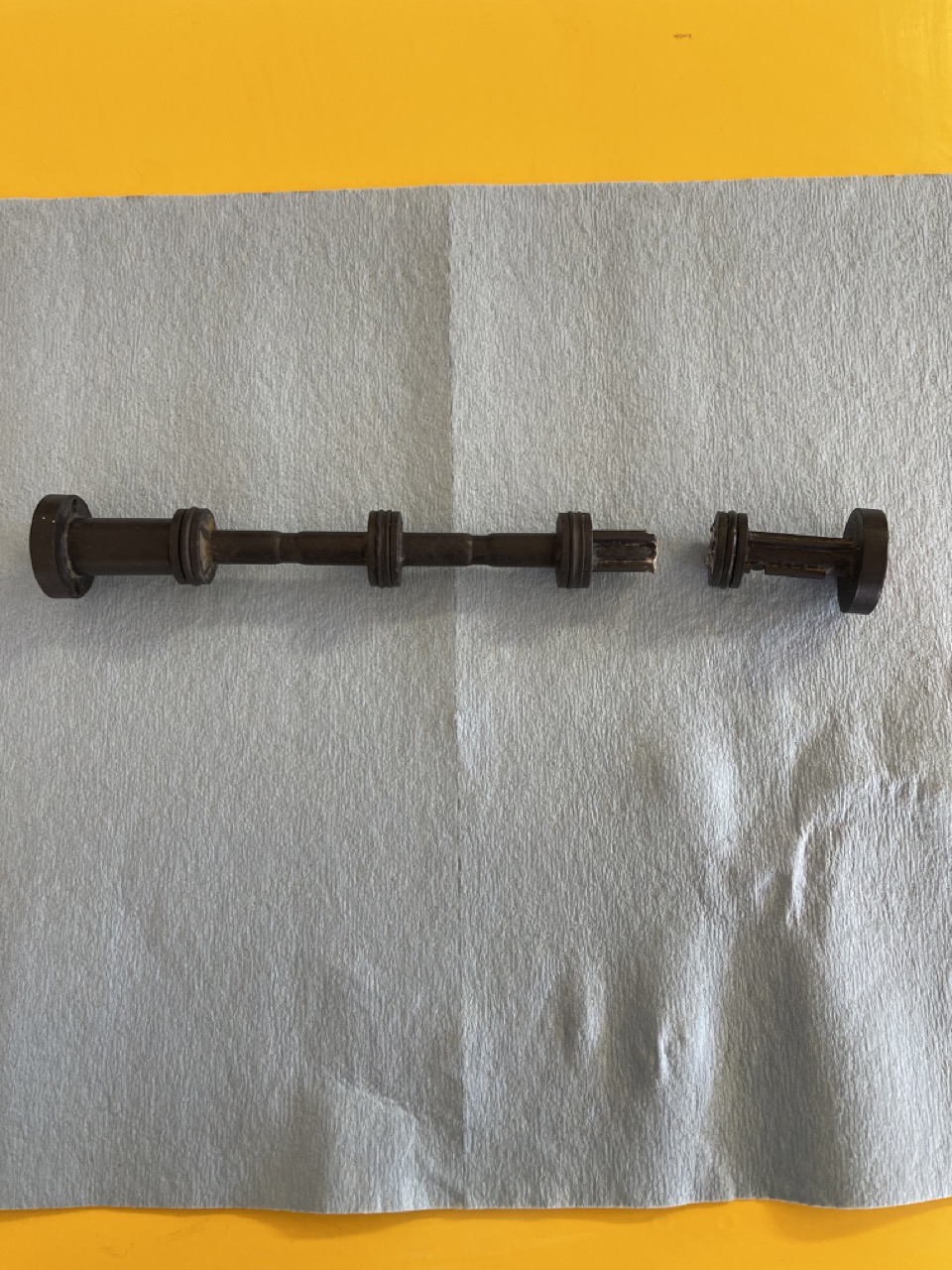

At this point I had to see what else might be going on. With the help of a lot of informative YouTube videos, I decided it was time to remove and disassemble the head unit for inspection. The head on this softener is in 5 parts (or levels) as they call them; level 1 is on the very top and level 5 on the bottom. None of the usual suspected areas within the head were bad, nor any nozzles clogged, but I discover that one of the big valves on level 4 was broken (this is a picture of a level 4 assembly, but this is not my level 4). (Picture of my damaged valve seen in second picture).
Example of a good level 4 unit
Here is a picture of the broken valve:
Also, you will notice a smaller valve slightly left of the center of the level 4 assembly. That "control valve" on mine was slightly damaged also so I decided I'll replace that as well. Fortunately, newer models than mine have a better-engineered control valve which is interchangeable with mine, so I ordered the upgraded version. I also decided to order a couple of little "float valve balls" for the unit just because.

Well sheets! I had all the repairs done, had replaced all of the resin in the two tanks and had everything hooked up and ready to try it out. But, as Roseanne Rosannadanna always said - "it's always something!"
As I was pushing the plunger of the softener bypass valve to bring the softens online, the danged plunger valve on the thing broke and water started gushing out of the valve! Of course this is a large brass valve assembly with a plastic plunger (I wish the plunger were brass) that is no longer made. However, I have lucked out and found the correct plastic plunger, advertised as "new," on EBay. Just placed the order (turns out it was from the same vendor that I bought a replacement control valve for the head unit on the softener). Fortunately the broken plunger still holds water (doesn't leak) as long as I have it in the "bypass" position. Sigh....looks like a few more days before I can put the softener back online and hope that it works!
