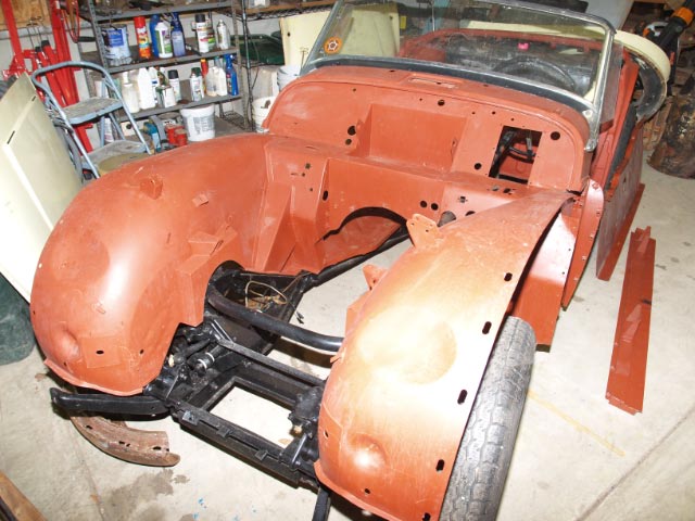

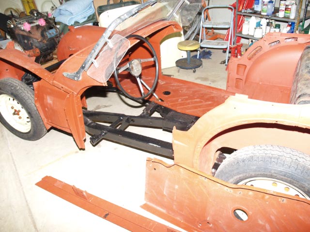

I am doing my first restore, though I was given a bit of a head start as mine was sort of abandoned as well. The body of mine was cut in two (front and back) and one sill, and floor pan already installed. Drivers side sill, and pan are loose. Original PO was in the middle of a frame off restore and suddenly passed away. He had bought a bunch of parts and there even is an extra cowl. The car was passed onto his friend who put it on ebay where we got it.
Body was dropped onto the frame but not bolted down. The gearbox cover is there, but the drivetrain tunnel (that was originally attached to the rear shelf) went missing. I am in the process of finding someone to fabricate one for me.
Otherwise, We've got brand new sills, pans rocker panels and a complete interior kit. Front fenders need some work, but I've seen worse. Hood, doors and boot lid are in original state and look good. They may have come from a donor car since the locks don't match the ignition key, but it could be a replacement ignition as well. Not counting the fenders or welding the sills and pan back in, I've got very little body work to do. Problem is, the underside of the car is basically unpainted, so it's gotta come back off of the body for a few coats of something to shrug off road junk. Might start investing in this one step stuff I tried on a small project (vape mod). I hosed the paint job on that up, and a friend who used to paint cars (now works in a Vape shop) had the worst time stripping that off. I think it was rustoleum. I am sure it was never intended for an automotive finish, but it is made for protecting bare metal and giving it some color (well black will suffice since I haven't decided on a color yet. I might use some as a base layer in the trunk, engine compartment and interior as well as the spare tire well. This stuff really bonded to the metal My Dad found a pretty close match to his BRG and did his trunk and interior of doors and trunk with it
Rattle can paint doesn't require specialist equipment at leastP1015966.jpgP1015964.jpg
For the underside one of the best products is POR15. It is brushed on and sets up very hard. If you use POR15 be sure to wear gloves as it sticks to you as well as it sticks to the car. A colour coat is needed as POR15 should not be exposed to UV.
David
With the underside paint,the body looks like it has red lead undercoat?which will only need primer and a topcoat which should be body colour and will outlast us all.
Graham
Nothing is attached to the frame, just the steering, brakes and rear axel (and tires to that obviously). Frame is done, and there's a new kit for it in packages waiting for me to figure my next move. I'd pick it up to paint it, but it's almost cut in two (floor pan and one sill are all that is attached). I may just have to eyeball it (well, a little bit more than eyeballing it) and weld that sill in. Then test fit the driver's door and if all is well, brace it and lift the tub back off for paint of some form, oh after installing two new rocker panels of course.
It currently has the same coating that comes on the parts from Moss and TRF (well I'm guessing about Moss, I'm already a TRF guy). Actually some of it looks brushed on, but maybe a trick of the light. Tub is smooth (tag light area could have been done a bit better but it's further down on my list).

As your drivers side inner sill and floor are missing you should use the frame to help you align the car. On my TR3A the PO probable removed the sills and floor with the car off the frame. I had a time getting the doors to fit. In fact when I got the car home I found the drivers door would not fit in the door opening by about 1/4"
Use the body spacers to get everything set to the correct position.
David
right now, the passenger side seems dialed in, test fit the door and it was perfect. I am considering welding just the sill in on the drivers side then bracing it and removing the tub. i checked the website on the POR, and it wasn't very clear on whether or not I need to strip the metal bare (of the coating already applied) before application. Will definitely use on inside of fenders (original paint inside and rust), rockers and sills. As I said, the rest of the car is coated, but only just.
If I don't need to strip it down, I wouldn't hesitate to coat the whole underside, inside the door panels, and the floor of the cockpit. If I have to strip it down before application, then I would probably go the other route, saving the POR for inside the fenders and splash guards and rocker panels.

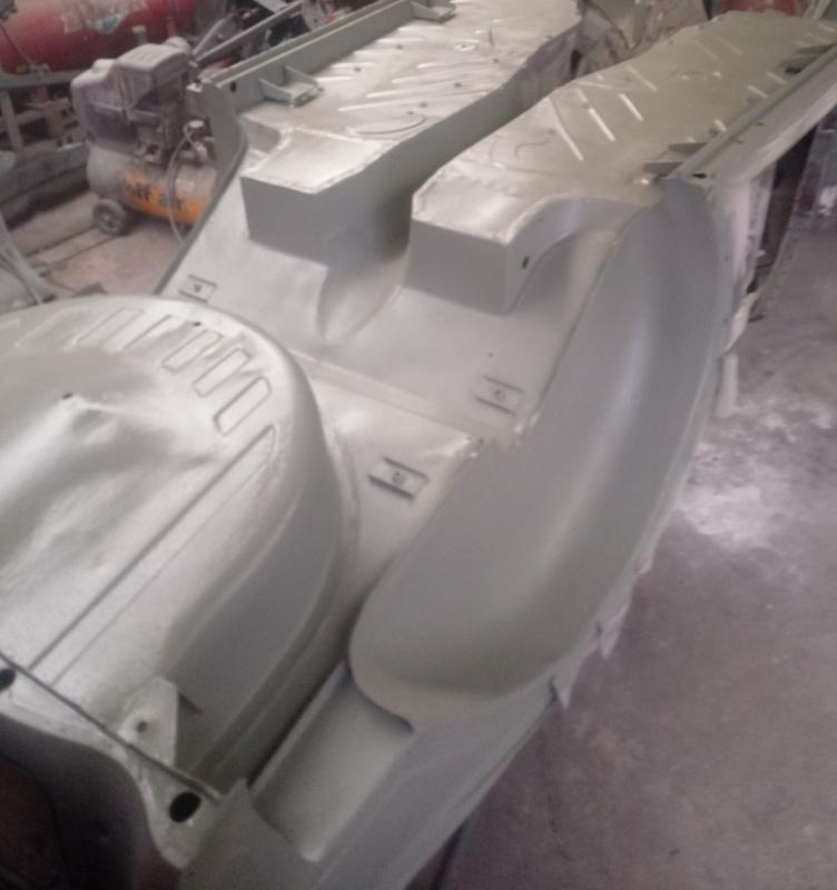

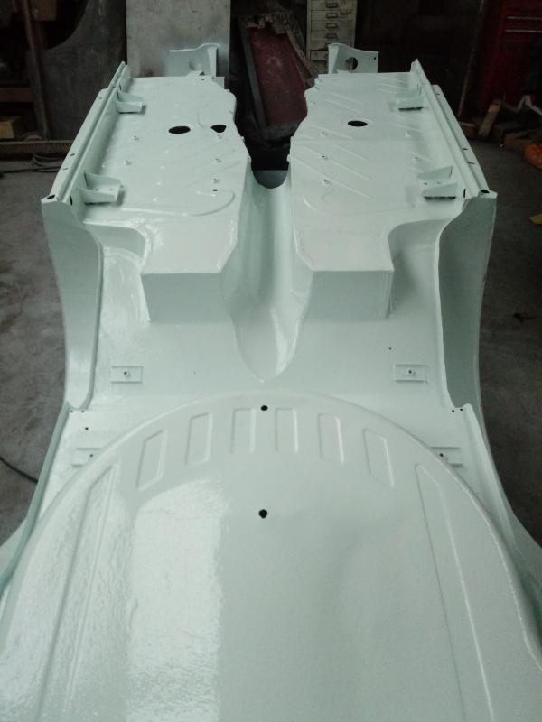

Moved on a bit , shot blasted , mlords rust inhibitor , 2 coats of etch primer , stone chip , 2 coats of primer .and white top coat . i was considering a total color change to British racing green .but iv went with the heritage certificate 20190203_154713-1.jpg20190210_161724.jpg
Blasting is very hard on compressors. Realized after one panel that my Sears 30 gallon one was not going to do it. The tank got so hot I could not touch it. Also I was getting a lot of water with my air. I could see the water being shot on to the panel.
David
After a bit of research and a few visits to the local paint supplyers , i had no luck in finding an original pearl white ,so i thought if i can not get the original colour il go with a colour want ..Britsh racing green
