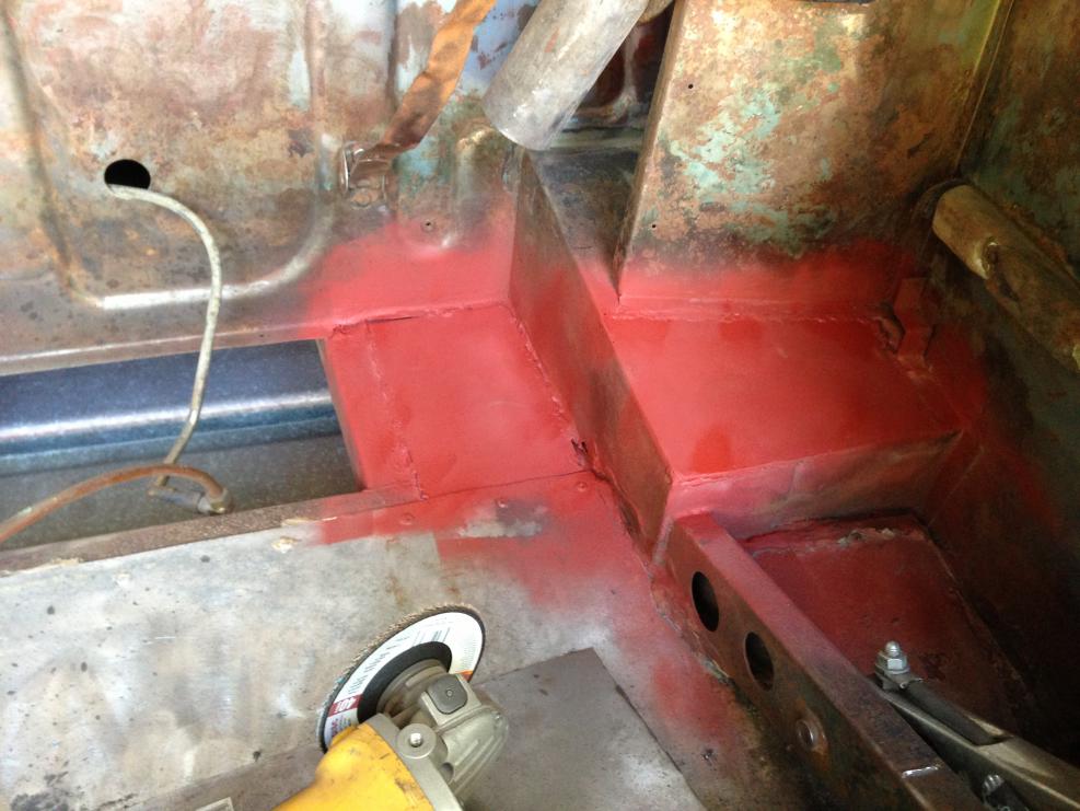

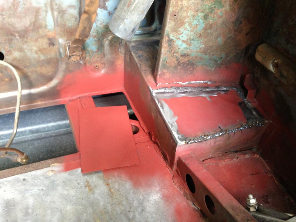

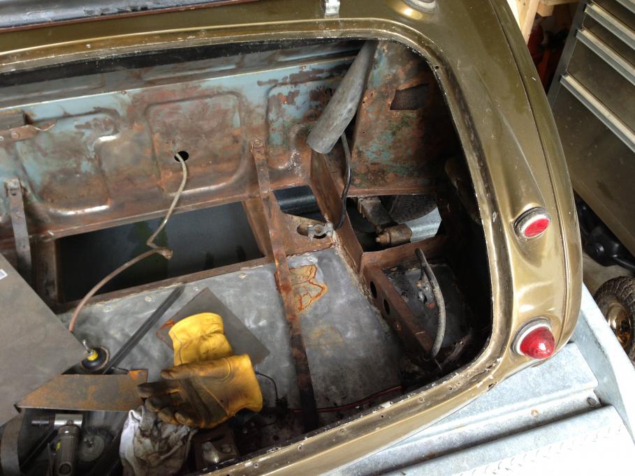

I decided to pick up where I left off a year and a half ago when I stopped working on this project and patch up some rot in the trunk. Here's a couple of pics. My welds usually look like bird sh*t, but they're especially bad since I was running out of shielding gas. But everything looks better after a good grinding. The orange paint is self-etching weld-thru primer. After I get another bottle of gas, I'll finish the patch, weld up some kind of battery tray, paint the trunk black, and install the new gas tank I've had stashed for a while. The original Armacord (is that what it's called?) was in tatters, so I pulled it all.

Looking good already, I believe you made the right decision, these are really fun cars , been working on my BT 7 for ten years got the engine running today. Do like Randy said when you rebuild something like brake components and clutch dont let it sit work the brakes and clutch so the seals won't dry up . Bob
