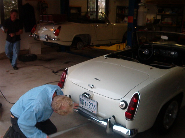

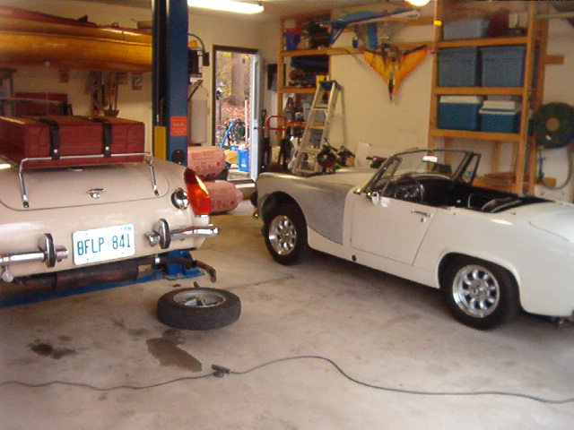

Well, it was a day. Mark and I had arranged to go see Phil in Carlisle to see about the vibration in his Sprite. Went to the bank, stopped for gas and Ms Triss wouldn't start and wouldn't start and wouldn't start. Walked home - 8 minutes or so, got some tools, got our tenant, drove back, swapped the plugs and away she went. Bethany (tenant) drove my car home and as we were chatting Mark drove up. And Ms Triss wouldn't start again, OK, we just barely got her running and away we went. Got there in good time - fabulous weather - 18 deg c (65 f) in November! Phil drove mine around the block to set the benchmark, and even then it still didn't start right.
Anyway, swapped my tires onto Phil's - they took it around the block and the shake was worse - much worse. The good part was the car had to go on the hoist while we took off the wheels so, I got to tighten up everything under the car while they were gone. "Honey can I have a hoist for Christmas, I've been good." "No dear, the garage is only 6' 6" inches high." That hoist is WONDERFUL - thanks Phil.
So, back to the story. Phil & Mark came back, put the wheels back on - cleaned the plugs, leaned out the carb three flats and away I went. Got Phil's Sprite up - pulled apart the drivers side front end, major lube and oil and we think things are better. Of course by then it was too dark to really see but, three spridgets in the driveway at the same time, a hoist, tools and a gorgeous fall day, how bad can it be?
Put the top up for the trip home and a good day was had by all.
Here are the pics I took. Ms Triss is on the hoist.
Hopefully Phil will be along in a minute with the pics he took of all the cars as mine didn't turn out.
