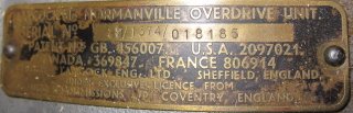

A very nice guy in big white truck just delivered an A-type overdrive to my house. It looks pretty good on the outside, but I won't be able to check it out thoroughly until this weekend with an expert/friend (Thanks, Jesse!) who is helping me out.
In the meantime, I have a question about the model number:
22/1374
Moss had a 6 thrown in there (61374) on its id page, but the great information on the web (from a lot of BCF members I might add) set me straight with that. I am happy it is a 3/4 box with the 2-3-4 capability. Good stuff!
Would you guys have any thoughts on why the second "2" appears to be stamped over another number that looks like a "6" or an "8"? Factory boo-boo?

Well the 22 is the final overdrive ratio, so maybe this was less a mistake than a configuration change? I thought Healey's used 28% overdrive, but that would make it an 8 instead of a 6..

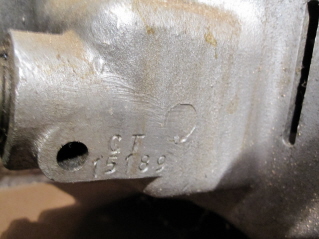

the gearbox has the stamping CT15189 on it.
That would make it from a 62 TR4.
Randy is correct that the A type ODs came in two ratios, 22% and 28%. TRs came equipped with 22% ODs, when they had them at all. I don't know where the 28% ones were fitted. The first two numbers, "22" or "28," before the slash, denote the ratio -- which, of course, could have been changed at some point in the 50 years since it was originally built/stamped. My OD has a "28" model number, but has a 22% gear set in it.
Either one will work fine in your car, with a 28% giving a little taller gearing, overall, and a 22% providing better intermediate ratios, when used between 2nd and 3rd, or 3rd and 4th.

I believe there were other ratios available as well; for example the Moss catalog shows early AH BN1 as having a 32% OD.
