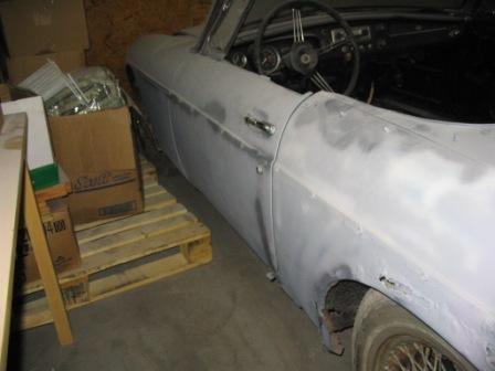

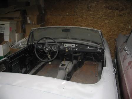

A new project? Opinions?
terriphill said:

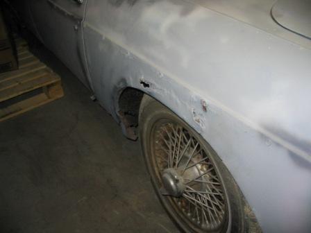

He says the frame rails are solid and do not have any rust.
But the car is monocoque construction so you need to be much more concerned about the door sill area. Given the obvious rust around the rear wheel, I'd bet dollars to donuts that there are sill rust issues. Better that you spend the money that you'd be spending on rust repair on an airplane ticket to a sunnier clime (California?) to find a rust free car.
