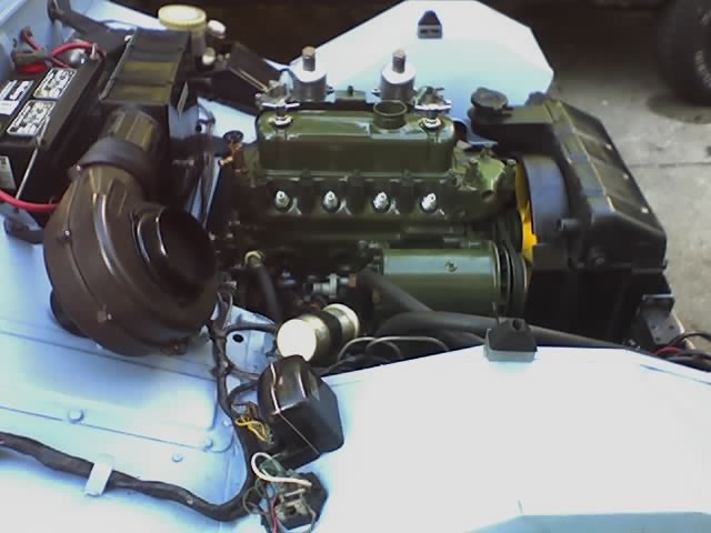

That sounds interesting. I am running a BE with a 1275, 9.5 comp, cam, ported, big valves, aftermarket intake, LCB, RC40, big exhaust, modified SU's, lightened Bottom end/flywheel, discs w dual masters, ribcase, 3.9, pertronics etc (that I have forgotten).
For me this is very hot, runs 80+mph on the highway w/o overhaeating, looks somewhat original and is a blast.
IMHO I know that the choice is yours, but save some money for the suspension, maybe 2k (etc-incidentals). And have some fun!!!
Keep your budget and dreams a reality.
Here is an old pic of the engine room.
Pat

Pat, you did take the paint of the water intake fitting and the radiator cap didn't you?

Jack - Nope, but I will since it bothers ya hehehe.
