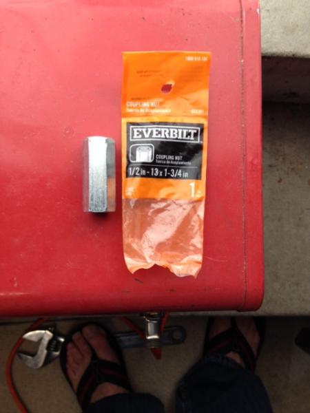

A great substitute for a "Not Quite 3/4 Inch" hex wrench
Chet Zerlin

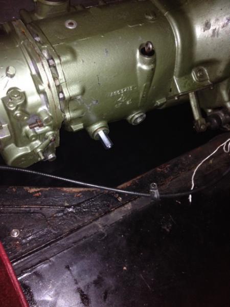

I needed to tighten up the large hex plugs on the side of my transmission. A 3/4 hex wrench is a little too big. When I couldn't find what I needed at local parts houses I visited my local Home Depo and found this. It's a coupling nut that is slightly smaller than a 3/4" hex and fits well into an 18mm socket. More importantly it also fits perfectly into the hex plugs. I just put it in and used my 18mm socket wrench to snug both plugs up.
Total price was $1.22 - by far the cheapest thing I've bought so far for my Healey!

Whatever works, works, right? You just happened to take the flip-flop method, while I went down the more cluttered steel-toe path ;)
Finished dimension = .7035" (17.87 mm, plus or minus):

Keoke, pretty sure those plugs are only on the side-shift box, leftover from the sedans with a column mounted shift lever (for them the shift linkage passed through those threaded bosses).

Keoke, pretty sure those plugs are only on the side-shift box.

Yeah, I was wondering which side of the box he was talking about.-:highly_amused:
