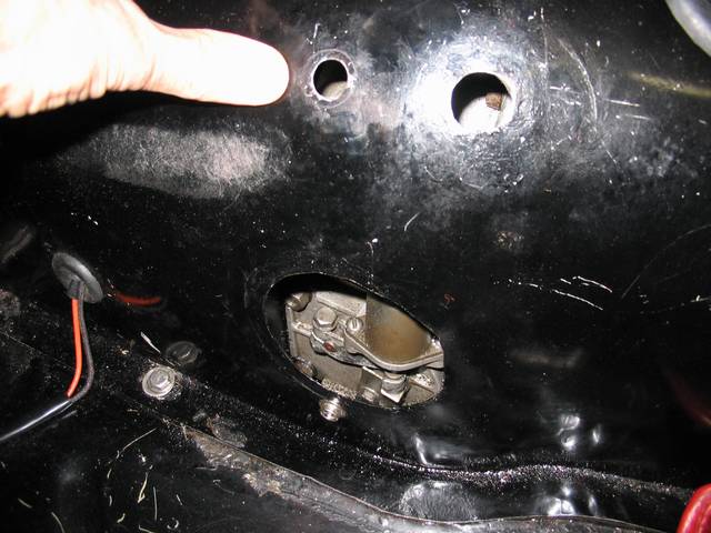

The tranny cover is attached, Grrr. I wonder how big a sin it would be to cut a nice neat access panel right above the interlock switches. Hidden from view by the carpet, nicely gasketed to keep water from splashing up later. Hmmm, I think I may become a sinner!
Tim :smile:
Tim - That's what I did for access to the solenoid on my early TR3A as well as for the oil fill plug on a later TR3A that I restored. Here's mine for the solenoid. I use a spare large rubber plug from the jack hole and two smaller rubber plugs you see up above for my very long screwdriver to gain access to the two slot-head screws which secure the body of the solenoid to the base casting of the overdrive.

It's your car, of course, Tim. But what happens when it turns out to be the ground lead to the lockout switches that is broken internally?
I try to avoid the swiss cheese effect wherever possible.
