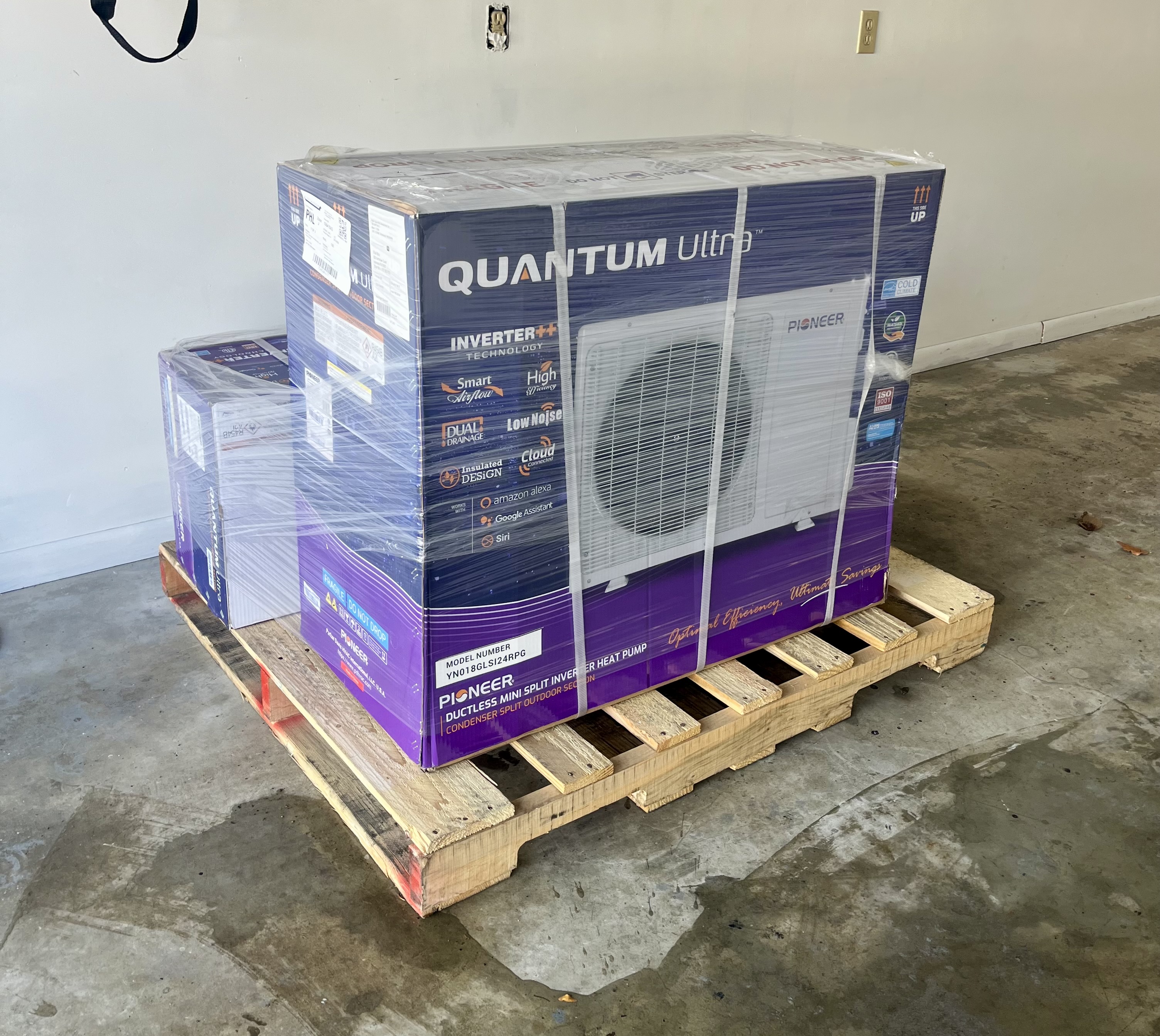

….I’m installing a mini split in my work area.
Bought a mini split to cool/heat my work shop. It was unusable all winter and in the summer the heat is too much to work in there.
Never attempted a HVAC installation before so I’m up for the challenge. Got a lot done today. Just have to move the outdoor compressor onto the pad, hook up the electric, and copper lines, then evacuate the lines. Hopefully it’s running next week if the weather cooperates.

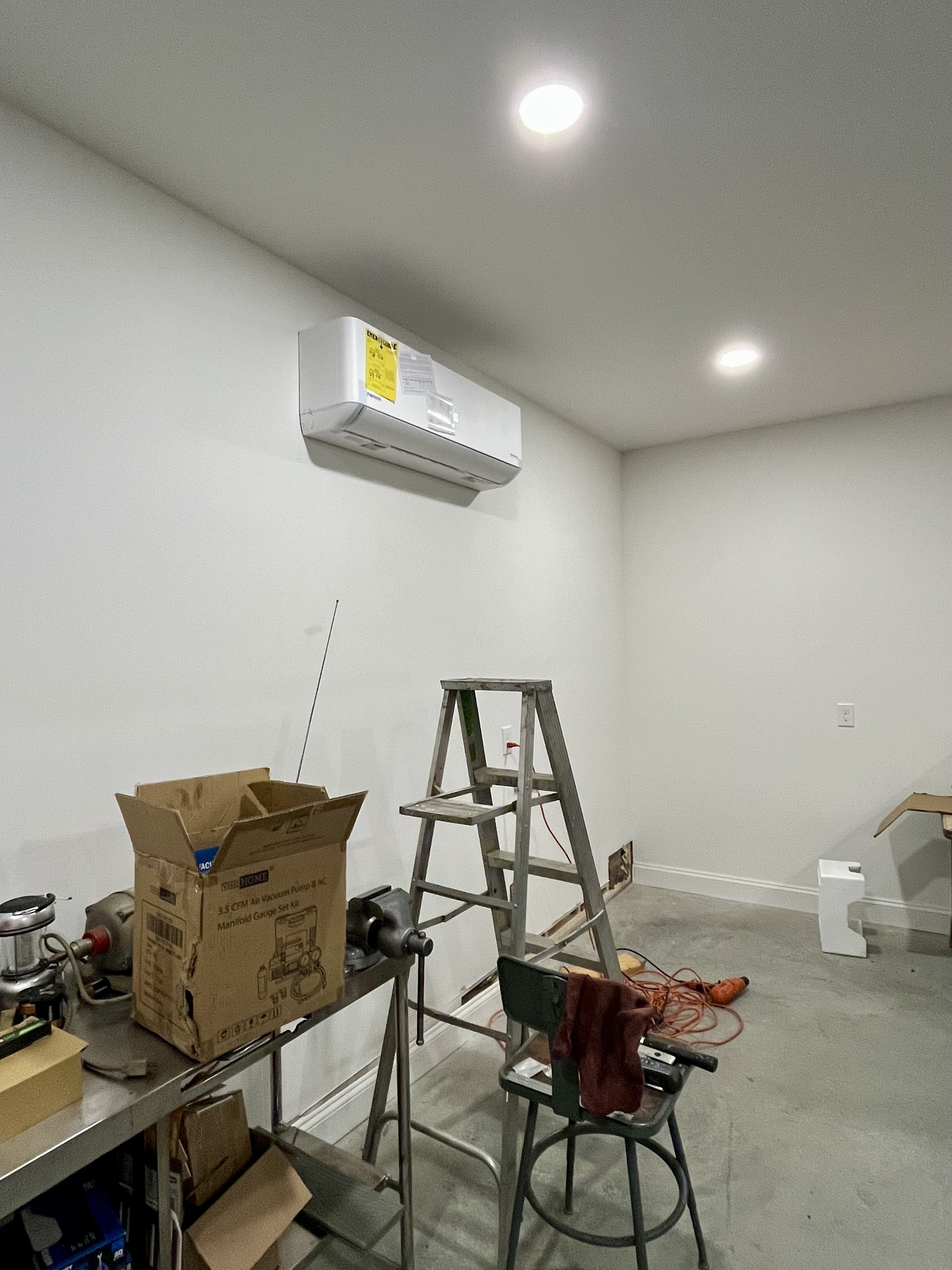

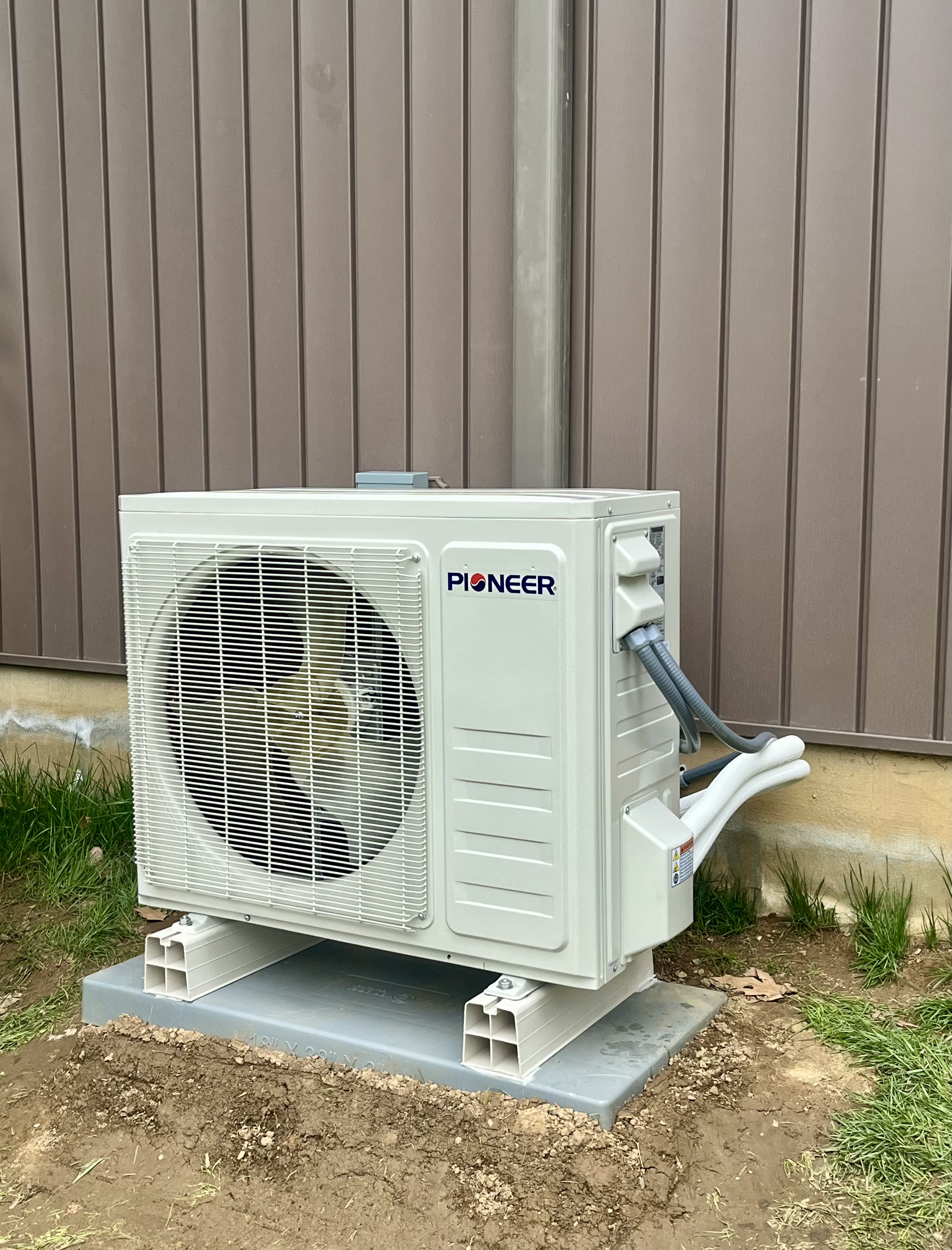

Installed!
I got everything done today….. 240V to the compressor, connections between indoor and outdoor units, vacuumed the lines and released the refrigerant.
I tested the heat mode and now I have a toasty warm shop. Tomorrow I’ll try the cooling mode, if the heat works, the cooling should too.

Clean set up. Are those isolator mounts to reduce vibration? Must be very hush quiet. Thanks for sharing.
Both the inside and outside units are extremely quiet.
I raised the unit up on riser blocks to keep the snow from blocking the condenser during the winter here in the northeast.
For warmer climates putting it directly on a pad would be fine. You can also hang it on a wall mount but for me, this worked out better.
