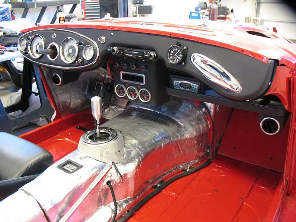

Well folks, I'm offering my experiences on installing a/c in my BJ7. This was a bigger project than I expected....but in fairness, I create alot of my own obstacles by wanting everything...function, style, serviceability, etc.... I don't think it needs to be this hard. Anyway, FWIW this link will get you to the write-up:
https://stevesaustinhealey.com/inde...d=9:ac-installation&catid=2:projects&Itemid=3
I would appeciate any feedback or sharing of your experiences. I'm sure guys like Roger and Lin could have done it better.

The hard part I had with my installation was the beadlock connections on the hoses. I clamped them myself and had two leakers. This required new hoses to be done and 3 times to get the unit charged up. They have a new hose and clamp on the ends now, I would use the new version.
This project is also easier with the front shroud off the car, and the dash out of the car.

Nicely done Steve. I especially like the heim joint tensioners. Simple, elegant and effective. Much better than a ratchet strap to the garage wall as you tighten the bolts. :laugh:
