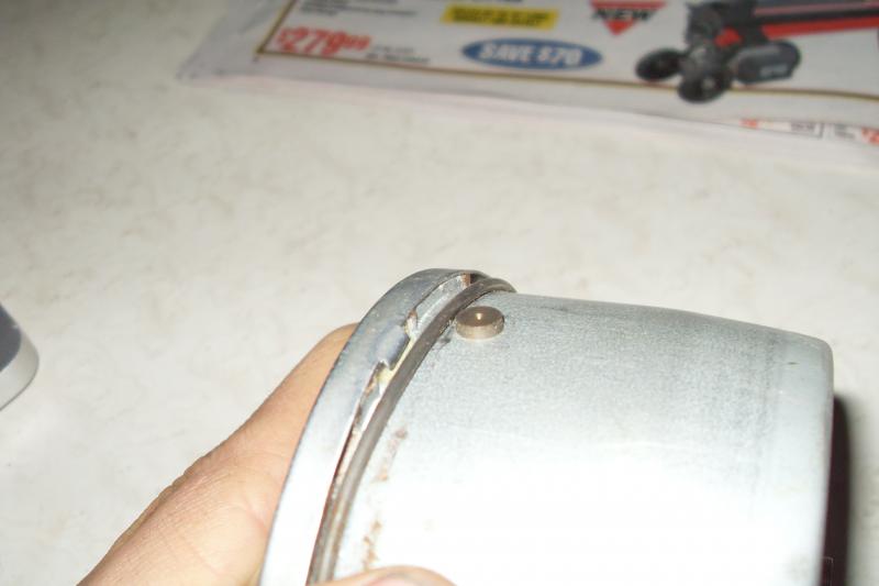

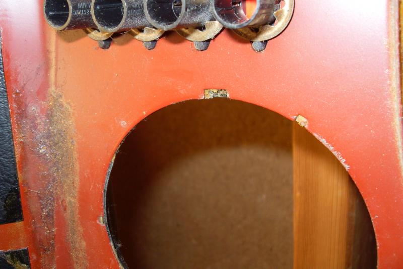

Thats a 78 B Spedo I just Pulled out a few months ago. Its held in by three cylinder shaped protusions. Forgive me I have no idea what they are called. by spinning the spedo 90 degrees they will line up with three holes in the dash just big enough to let them out. The third picture Is the back of the dash. you can see where the cylinder protrusion would slide out in comparison to the line of idiot lights.
Easy version-
grab the spedo and spin it 90 degrees. Push it from the back and it will pop right out of the dash.
I knew it was something easy. Thanks very much. Any idea how to get the needle off without breaking anything?
