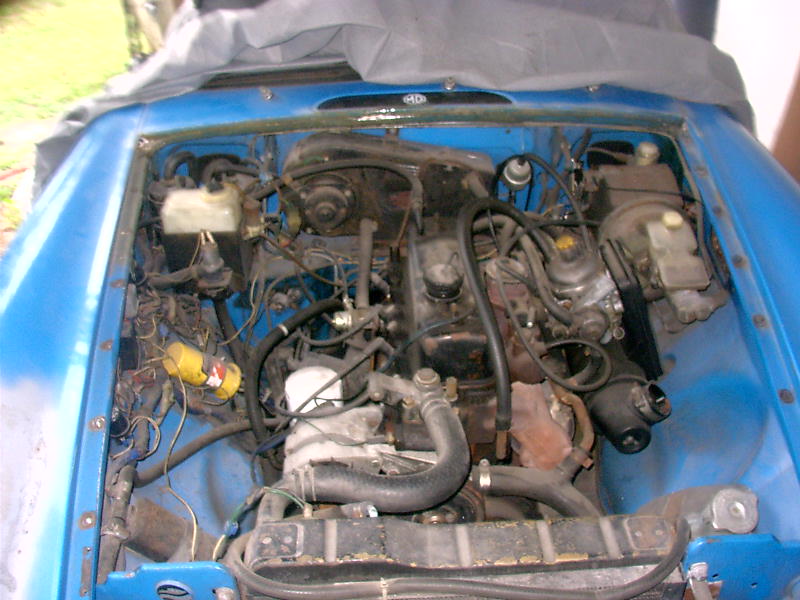

Here you go eh,
Need a different angle?See attachment.
Rick
Rick - In addition to the obvious (air pump, air injection manifold, gulp valve) there are a few things missing from your photo...& some things routed incorrectly....i.e., vacuum advance valve & its lines are not there along with a couple other electrical & vacuum lines.
From the distributor to the vacuum advance valve mounted on the front corner of the pedal box cover & then to a vacuum port on the intake manifold.
Oh, its a tiny plastic line which has normal rubber ends - formed ends at that.
