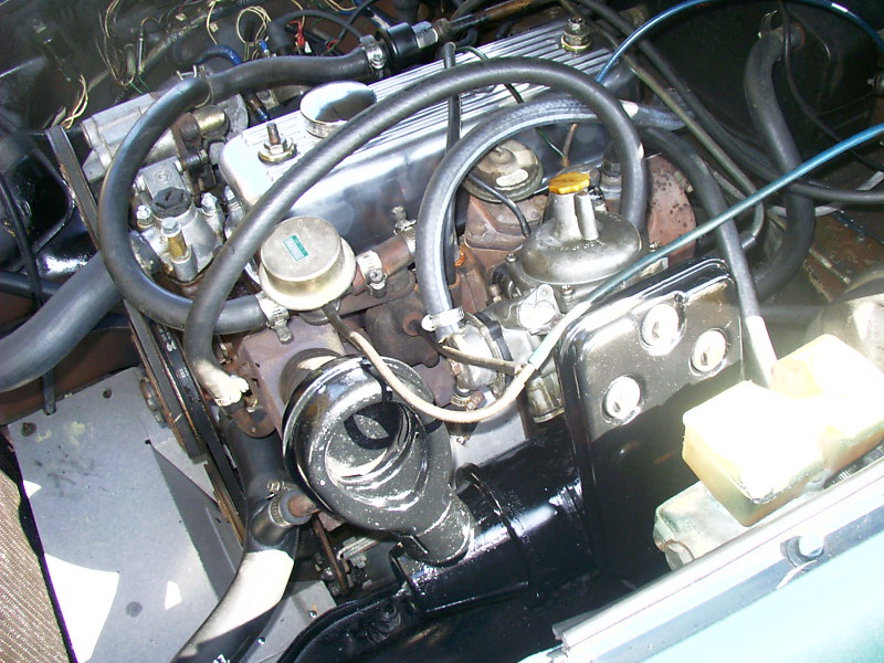

The vacuum line coming off of the intake manifold has a “T” on it. From the T it goes to the Gulp Valve and the 4th gear vacuum advance valve mounted on the brake/clutch box (just to the right off camera) from the 4th gear switch the hose goes to the vacuum advance hookup on the distributor. However many folks don’t use the 4th gear switch or have removed it. If your 4th gear vacuum switch is missing just run the hose to the distributor.
Sidebar: Keep in mind if you don’t have a 4th gear switch – that you need to remove & plug the vacuum advance line when setting your timing or are having the vehicle smog tested. But you still want keep the vacuum line going to your gulp valve.
Here is a pic that might help with the vacuum lines routing.
Good luck!
Bret
