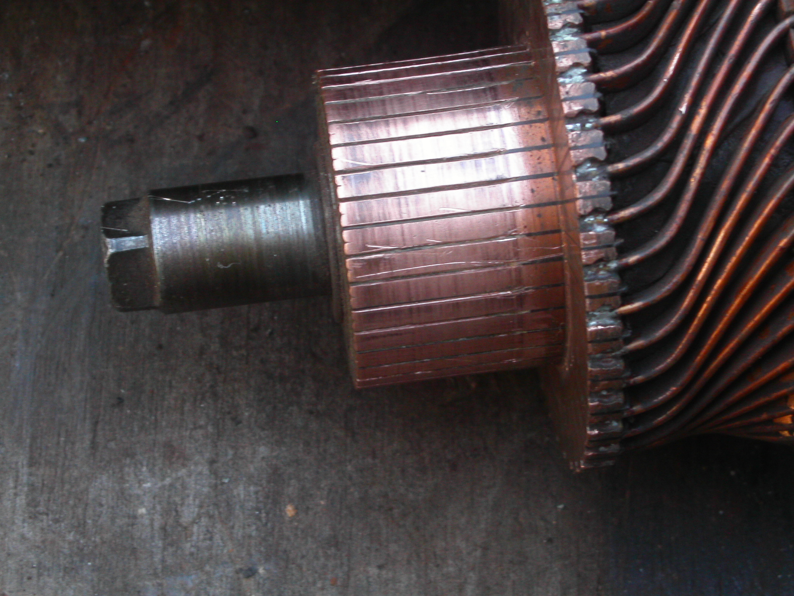

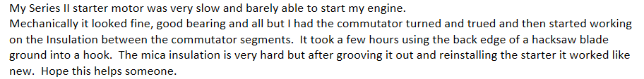

DougME
From my 1960 Land Rover Lucas Starter motor:
Madflyer
Doug is right on! I worked as an Elevator repairman for 40 years and did just that many times on old units. copper wears down mica does not. repairing the starter may be something for you to try if you have the knowledge or time to play with it. Or just get a new one. Option two have wife push start you. Kidding but I have had to do that a time or two. Still married after 50 years.
