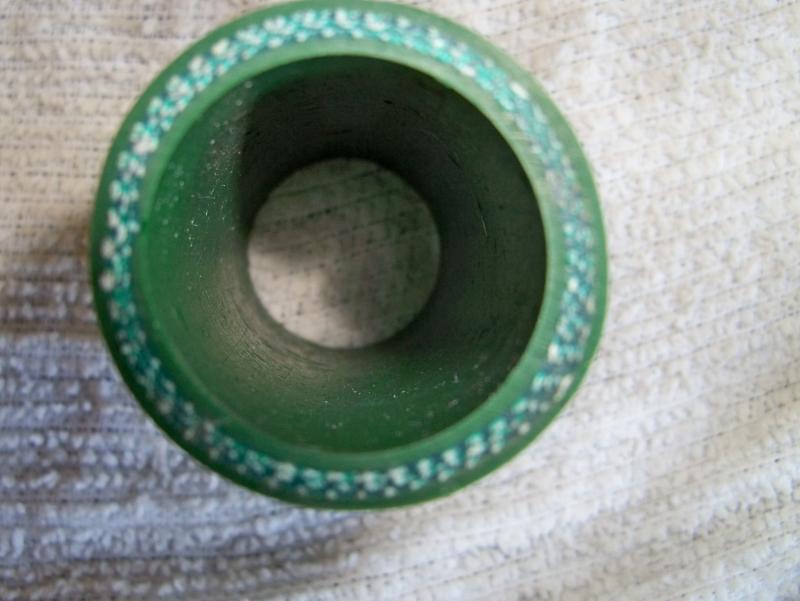

Take a look at yours...if it's not reinforced such as this, although they may be pretty, they aren't structurally sound. Silicone Hose 002.jpg
Good photo, thanks. Mine don't look like that, with the interior webbing .. but neither do the 25 year-old hoses I just took off the car. Hmm. But I will hang onto them.
