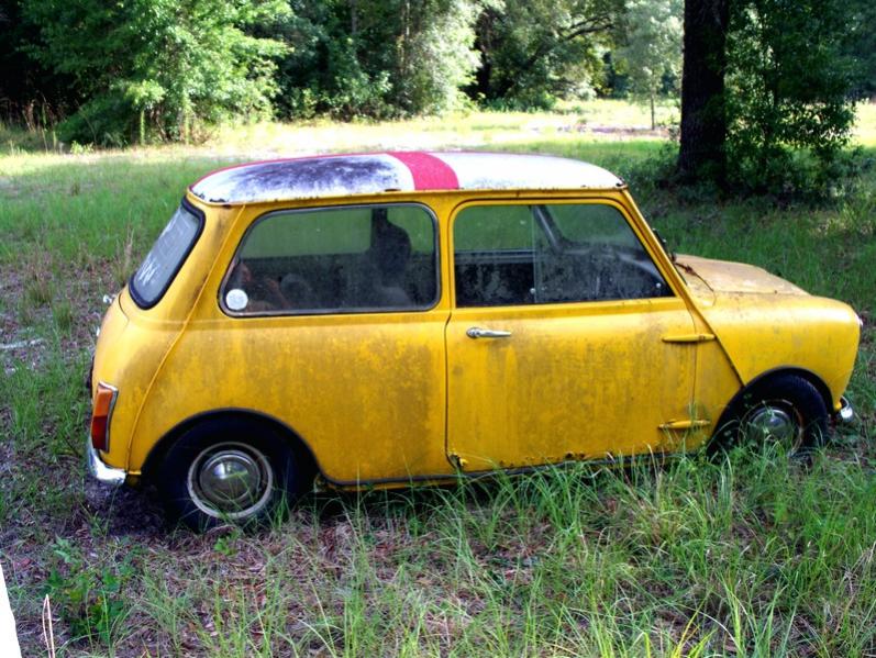

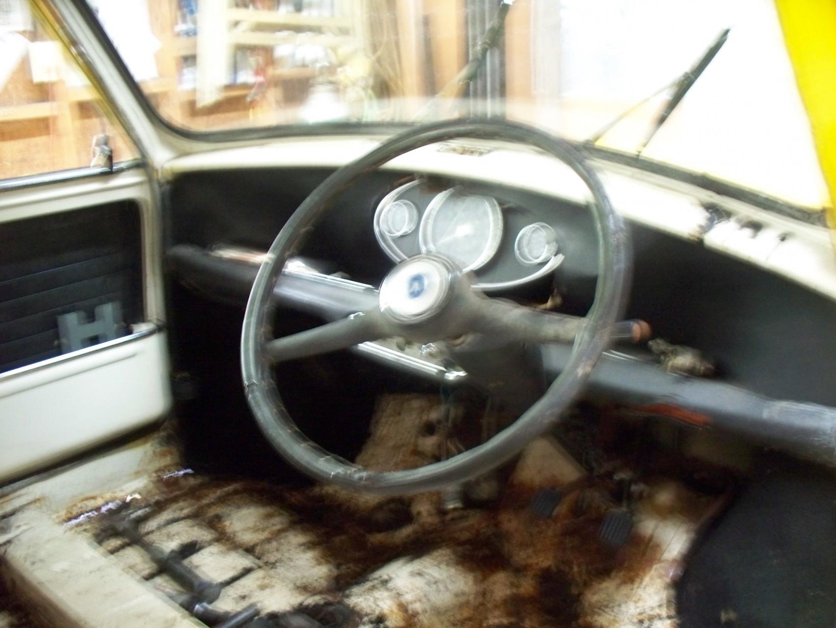

On the shifter I pulled the remote completely off, and have shifted the peg, and can hear the forks inside selecting....... something...... the underneath is in tack, nothing stripped off. I was letting the pistons soak in oil for awhile and recently did a compression test, not good 3- 60# and one 120. So my desire to at least run the mini so I know whats there is gone for now. Like Larry said put it up and wait for next year tear down.View attachment 33627View attachment 33628View attachment 33629 A (11).JPGView attachment 33639A (10).JPGAND THATS THE GOOD SIDE...........

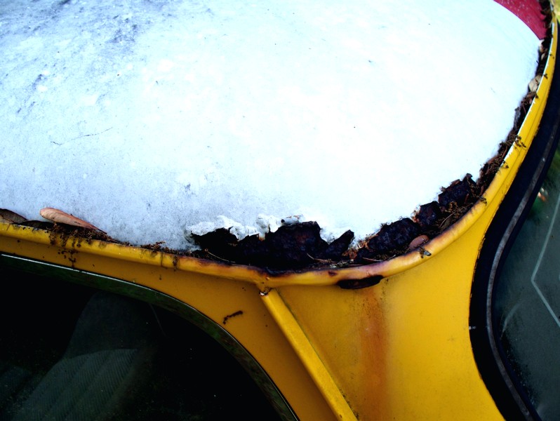

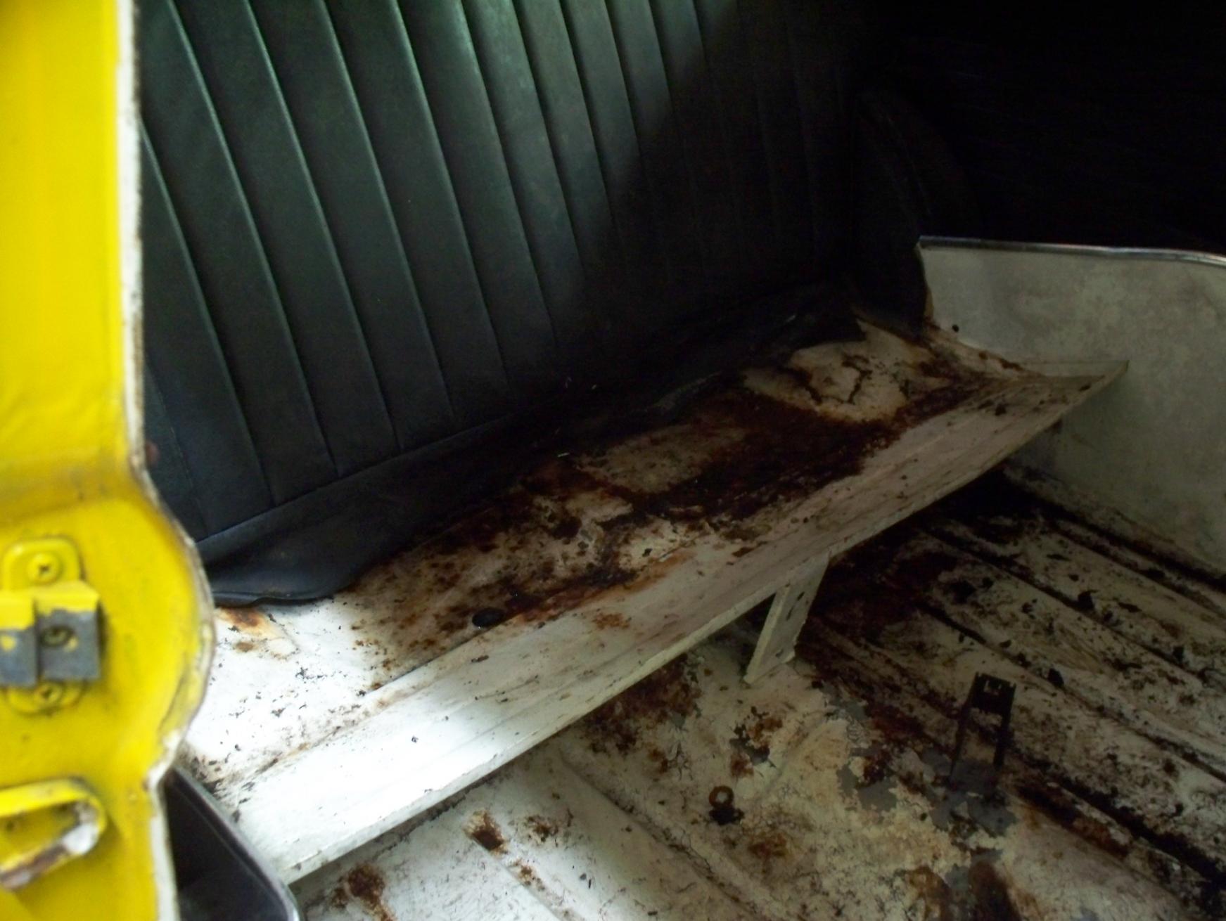

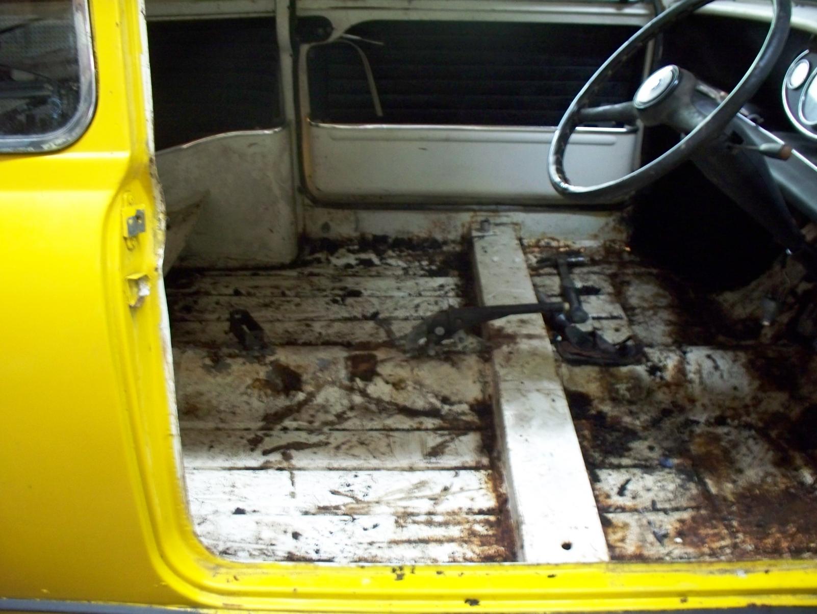

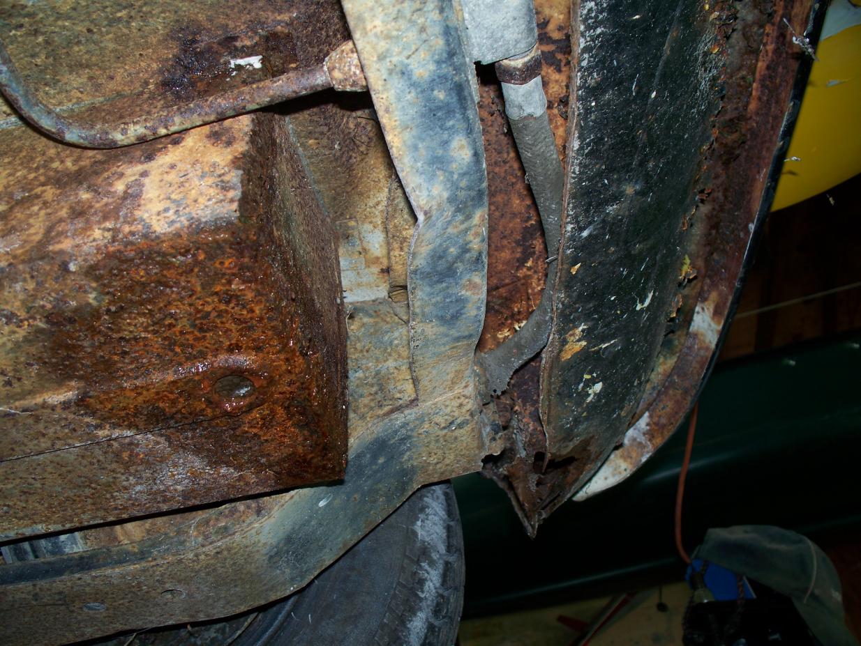

The roof looks like no fun at all. How are the floors, sills, and boot floor?

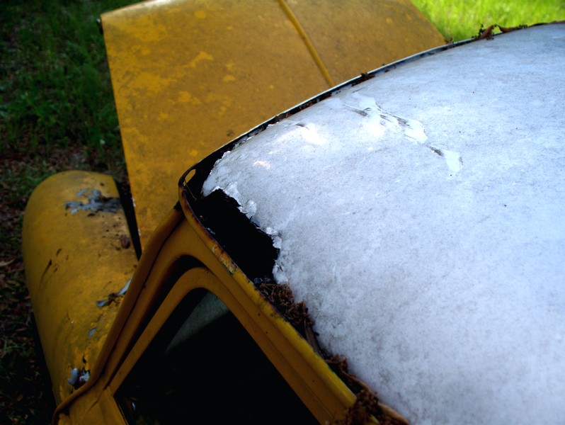

The floor is better then I expected, being it was sitting on four flats in the sand, there is some rust thru at lower doors and inner sill's but it isn't too awful. Thats one of thoes thing you don't know how much long strand fiberglass bondo you need till it comes back from the sand blaster. The front end is all bondo with rust pushing it out in places like the photo of the left side fender- body junction I wasB (20).jpgB (19).jpgB (18).jpgB (13).jpg kind of thinking about taking the roof off and doing a full convertible top, like the jeeps have. Saw a posted photo of the mini like that. Slide windows and Florida summer is not going to work well ! I have $200 in it, plus $200 NOS tires and grill, plus $200. to straighten out the title from being imported from New Zealand about 10 years ago. So I have a little wiggle room before my wife starts chasing me with the tire iron !

Cutting the roof off? Cutting off the roof is probably OK if you build and install a frame underneath the car to stiffen it. The sills on a Mini are important but the roof contributes an important amount of stiffness to the car. Don't cut it off without stiffening the body elsewhere.
Though purists would disagree with me, I would feel perfectly OK using that long-strand fiberglass to patch the roof corners and the floor. Alternatively you are going to need a roof from a donor for your project. New roofs are expensive to buy and ship.
When you were talking about the existing bondo on the left fender, did you mean the rear fender (quarter panel)... just behind the door? That is probably all skim coat to build up the panel so its height matches the door curvature. It may not be as bad as you think.

Well, for starters, it's not a 72. That is a MKII Mini, can only be 1967-1970. Late 70 on would be a MKIII with different doors with wind up windows, concealed door hinges and, no door pockets.
That car would also have originally had Hydrolastic suspension instead of rubber cones. Just looked closer at the pics, and, it still does have the Hydro suspension.
