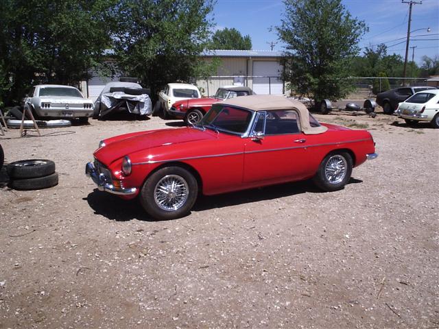

This drove into my shop yesterday...a local body shop is pals with the owner, has been there over two years. I won't even tell you how much has been spent on this car...I about fell over when I was told) Anyhow, apparently the brand new wiring harness has a short..or the new lite switch does as every time the car is started, the lites turned on...the signal lite switch goes up in smoke. Today the troubleshooting starts....heres a couple of pics....

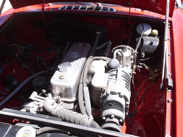

A peek under the hood..notice anything ?? The car has 129.1 miles since being done...
Awww....the poor car has COPD....it needs a ventilator!!! :laugh:
Looks like a 69 to me (3 wipers). Must have had the side reflectors removed.
