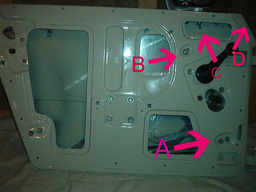

it's not that hard to dismantle the door - I can post some pics - my door is reassembled but it will also be the chance to replace the window rubbers and felt

OK - I probably should have said Picture not pictures. Anyway, here is the door reassembled.
A - is the bracket that holds the bottom of the front channel in place - this is the bottom of the vent window bracket - remove them.
B- is a "spacer bolt" that maintains the curve of the channel - remove it.
C - is the two bolts that hold the vent window down and
D - is the two bolts that hold it forward.
I think (help me here folks) you can remove the whole thing without removing anything else. At the very least you can get it an inch high to improve the paint seam
