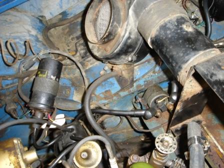

How does it go?
I know which hole it goes through the firewall (the same one as the capillary line)....but I don't know how it gets there from the engine.
Photos?
Here you go Tony, it runs under the heater fan. The black tube is the Oil pressure gauge line. I think it was held in place above the heater to a clip on one of the plate screws.
Mark
Hmmmmmm....thanks, Mark....my line has a couple of loops in it under the dash near where it goes into the guage - does yours?
I can't tell from the photo - but is that line supported anywhere except that one place where its held in the same clip as the temp line? I mean, is it held anywhere near where the flex line switches to hard line?
Tony,
It was not held anywhere else as it was a stiff lie with the rubber hose part acting as a cushion between the frame and the motor.As mentioned the metal line part of it was attached to a clip which was attached to a bolt on the cover plate. I looked through all my tear down picks and I do not see a loop. Mine came straight out from the back of the gauge through the fire wall.
Mark
