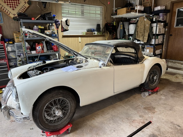

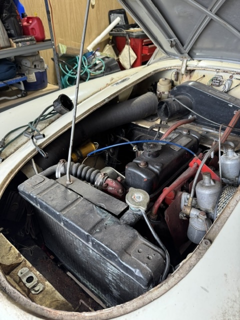

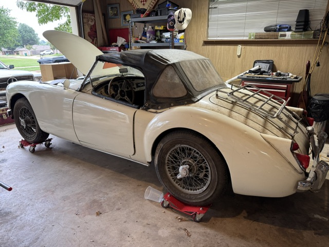

My last post vanished...not sure what happened, but I thanked all you for your responses. I have read and downloaded a lot of material and created a lot of bookmarks.
I will try and post some pics, but I know the car runs and the body is in great shape - not "show car" shape but good enough for me to enjoy and my kids down the road.
Here's what I'm planning - I am installing new plugs - same as my Dad had in the car (Champion RN9YC - wires and cap and rotor look great). Changing oil using Valvoline 20W50 racing oil, new Wix filter (will tackle possibly adding spin-on adapter later). The car had a metal inline fuel filter under the hood and I'm replacing it with a Wix. Plan to use 89 Octane regular unleaded gas (I think my dad added some lead substitute stuff, but I'm not sure I need it ???).

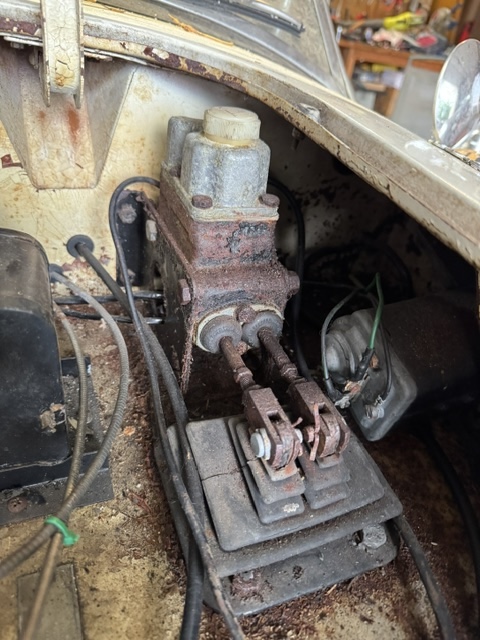

My major concern is the brakes and I'm trying to decide how to proceed. The current MC is pretty rusted and I'm pretty sure Dad told me it was bad. Should I attempt to rebuild, or replace? Read some varied reports on the reliability of "Classic Gold" vs "TRW" vs "AP"...
I know Dad already had the wiring issue fixed and did have the harness replaced.
Wading in to a whole new world here, but am excited.
Thought I w

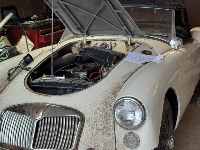

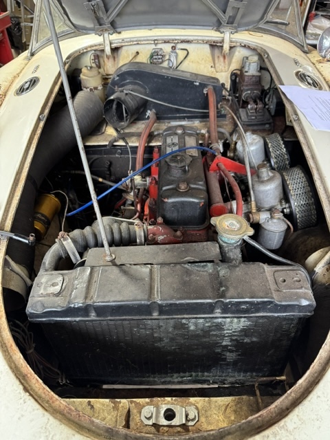

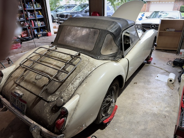

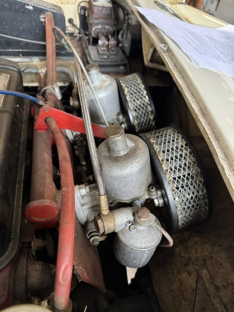

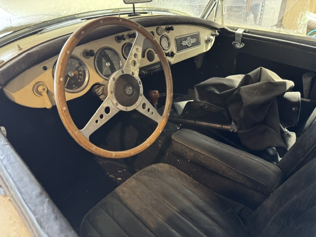

puld try some pics...
If you can rebuild it do that. The rebuild kits are cheap ($13 at Moss) Rebuilding is not difficult to do and will give you confidence. If you dismantle the MC and look down the bore - if you see pitting, that is problematic.
If pitted, rplace or get re-sleeved. Generally newer parts aren't the quality of older ones but, I have a newer MC and it has been fine.
Plan on rebuilding the braking system - kitting all cylinders etc., and check all suspension carefully for wear. Otherwise they are pretty basic mechanically and you can work out what isn't functioning properly . and what needs to be done to restore proper function.
