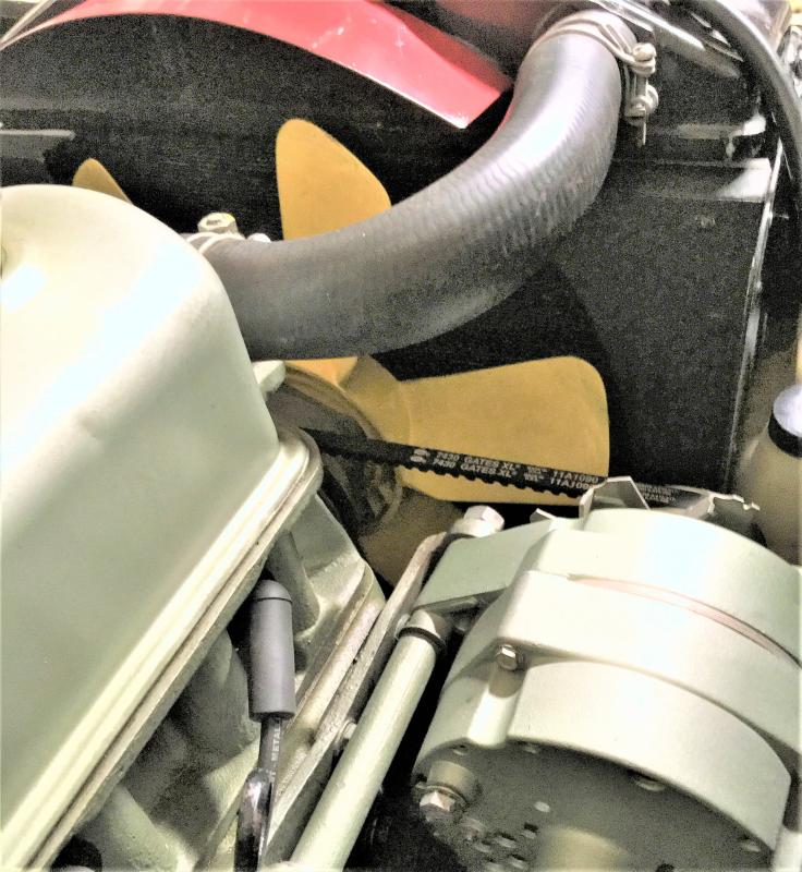

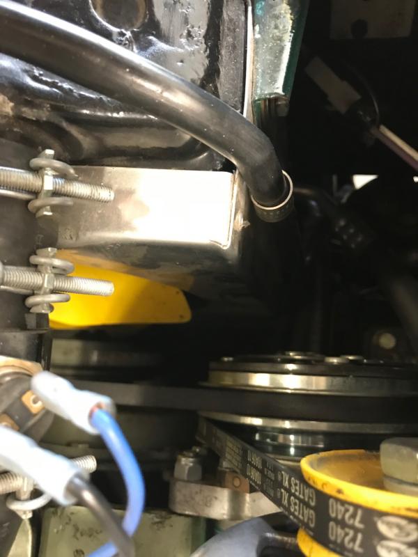

John Turney
I've been asked for photos. Because the car is together, you don't get much of a view.

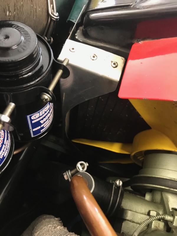

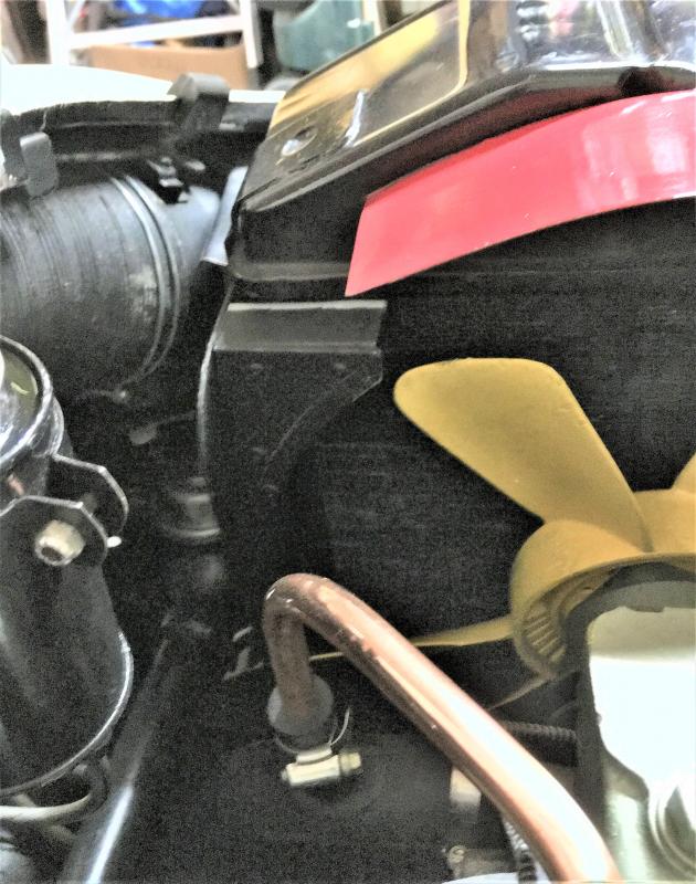

RAC68
Hi All,
Yes, it is difficult to take pictures of the installed shroud. My attempts were even more difficult as I had painted the panels flat black purposely fade into the background. Keep in mind that I have also added forward panels, extended from the shroud, to enclose the path between the radiator's core and Healey grill.
Hope this helps,
Ray(64BJ8P1)
