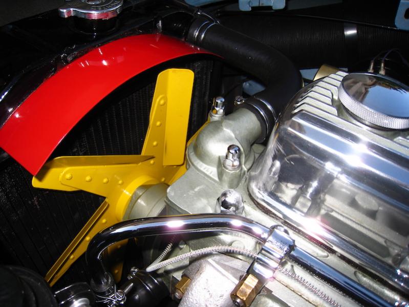

British Car Specialists sell a Flex-a-lite 6-bladed SS fan that is very sturdy.
I'm using the same fan. I had it power coated yellow.
