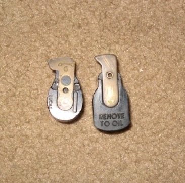

I endured a spell of inexplicable bad running; OK idle but stumbled badly when driving. Messing with fuel, coil, even the High Tension lead between the coil and distributor made only minor improvements. I dug out an original Lucas rotor and instantly the problem went away. I'm now using the 1974-vintage Lucas rotor and hoping it holds out until I can find another!.
Further experimentation showed the #4 HT lead got no spark at all with the non-Lucas rotor, even at idle. I wonder if the rotor was shorting to the breaker point post, which sticks up and is closest to the #4 HT lead.
Here's the two rotors. There's a slight difference in the arm profile, so who knows.

When I still had points in my distributor, I had a condenser fail in the same manner that Dale describes. It was all over the place trying to track it down. I've also seen coils fail in the same manner.

Paul offers good advice, I would like to add to it. Also replace the condensor. You are describing condensor failure. Had a batch of Honda ones go bye bye back inthe 70's. They were fun to diagnose..

Did 1 thing this afternoon-replaced condensor
Car started immediately on 1st crank
Warmed up to 800 rpm
drove 800 L.F., 1st gear at steady 3200 rpm
returned and parked at home.</span>

A good condensor will last a loooong time. Way to tell if your condensor is going bad is to look for metal transfer on the points. If you've got metal building up on one post and pitting from the other post you need to replace the condensor.
In days of yore we would actually check the capacity of the condensor and go higher or lower, depending on whether the metal was on the positive or ground side post.
But then tuneup kits started including the condensor with the points. Because they started making condensors that would just open circuit internally and fail...
A good cap and rotor(someone gave you a site that looks worth investigating) should last at least 12000 miles.... Same with good, lubricated points and a condensor.
