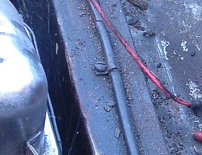

There is a small hole, probably for a clip of sorts in front of the battery on that narrow horizontal ledge dead center spanning the length of the battery box. I have looked at dozens of pictures and cannot find what may have gone there except one shot in one book but I cant make it out. Could it be the OD wiring?

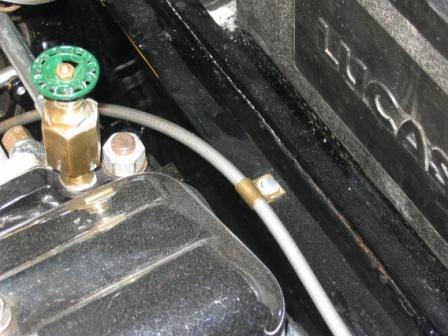

Great Pumpkin - R.I.P
Close. When OD was fitted, the speedo cable ran across that ledge, with a clip in the middle to hold it there.
