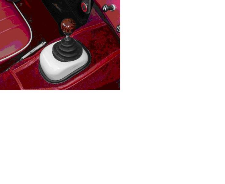

Devin, I enlarged the shifter cover to fit the early MGB gaiter. I ordered the gaiter from MOSS.. After fitting gaiter size to the enlarged hole I Super glued it in.
This is what mine looked like.....used the MGB gaiter.

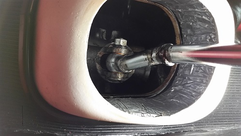

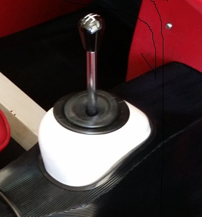

I cut the Datsun shifter below the bend and spun it to center it. Cut above the bend to shorten the overall length. I don’t see any reason you couldn't use the top portion of a stock shifter. I considered that but did not want to cut up the stock shift lever.
I enlarged the hole in the shifter cover and used a 3000 center shift boot. Threaded a Bugeyeguy shift knob right over the metric threads.

I really like the shifter in 60FROG much better then the stock Bugeye one. It is much shorter and makes for really easy shifting in any gear.

I shortened up the shifter in my BE and went a bit too far. Really have to concentrate to make sure you hit the gates so it is possible to go too far. Other than that I like the shorter lever.
