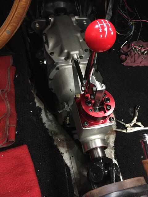

Hi Mike, This is a very original 22k mile Healey. The problem is that the FWD U-Joint needs to be several inches further forward. The sliding yoke into the Transmission will move forward with the driveshaft disconnected from the rear. It's like the driveshaft tube is too short. I attached a picture. I have installed several Smitty kits. One in my own BJ-8 and some for friends in Austin 100's and all six cylinder models. I never had as many problems as with this kit. The selling point was the new transmission with the Toyota transmissions getting hard to find. A forum for people installing these kits to help others doing the same would be great for anyone attempting to install or contemplating buying the Driven Man kit. Thinking it will be a good conversion with the install problems resolved. Their tech support has been ok , but not really Healey specific. They sell kits for several American and British cars.
Another similar T5 install in a Healey shows the driveshaft U--joint forward of the transmission tunnel. this looks to be a v8 install. This would not interfere with the hand brake in the tunnel.

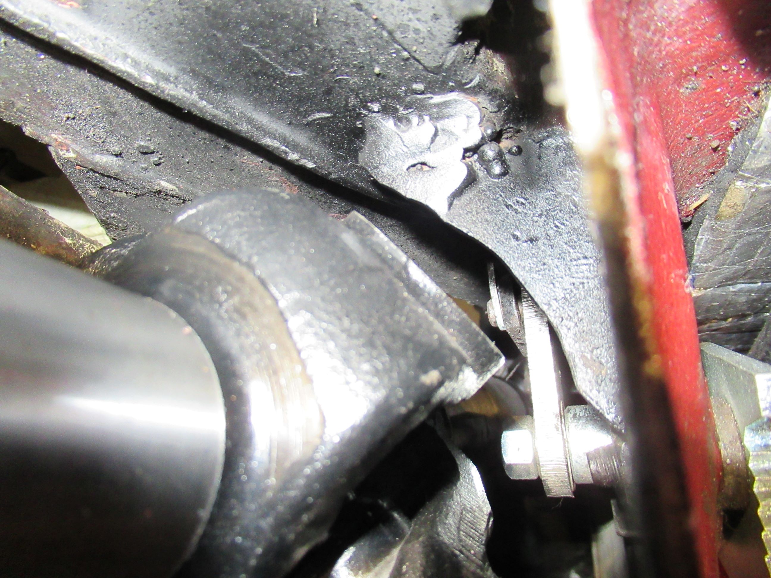

I sorted out the drive shaft clearance problem. First I relieved the hand brake mount support. It's a little 45 degree brace welded to the mount. I then noticed I had to slightly pull the transmission to the R/H side of the car for the rear mount bolts to align, with the mount plate. This contributed to our clearance issue. With the transmission in place without any preload it was in a better position. I decided to open up some of the holes in the rear mount plate where it attaches to the frame rails to eliminate the need for the preload. With that done and a shim under the rear transmission mount to raise it slightly, we seem to be good.

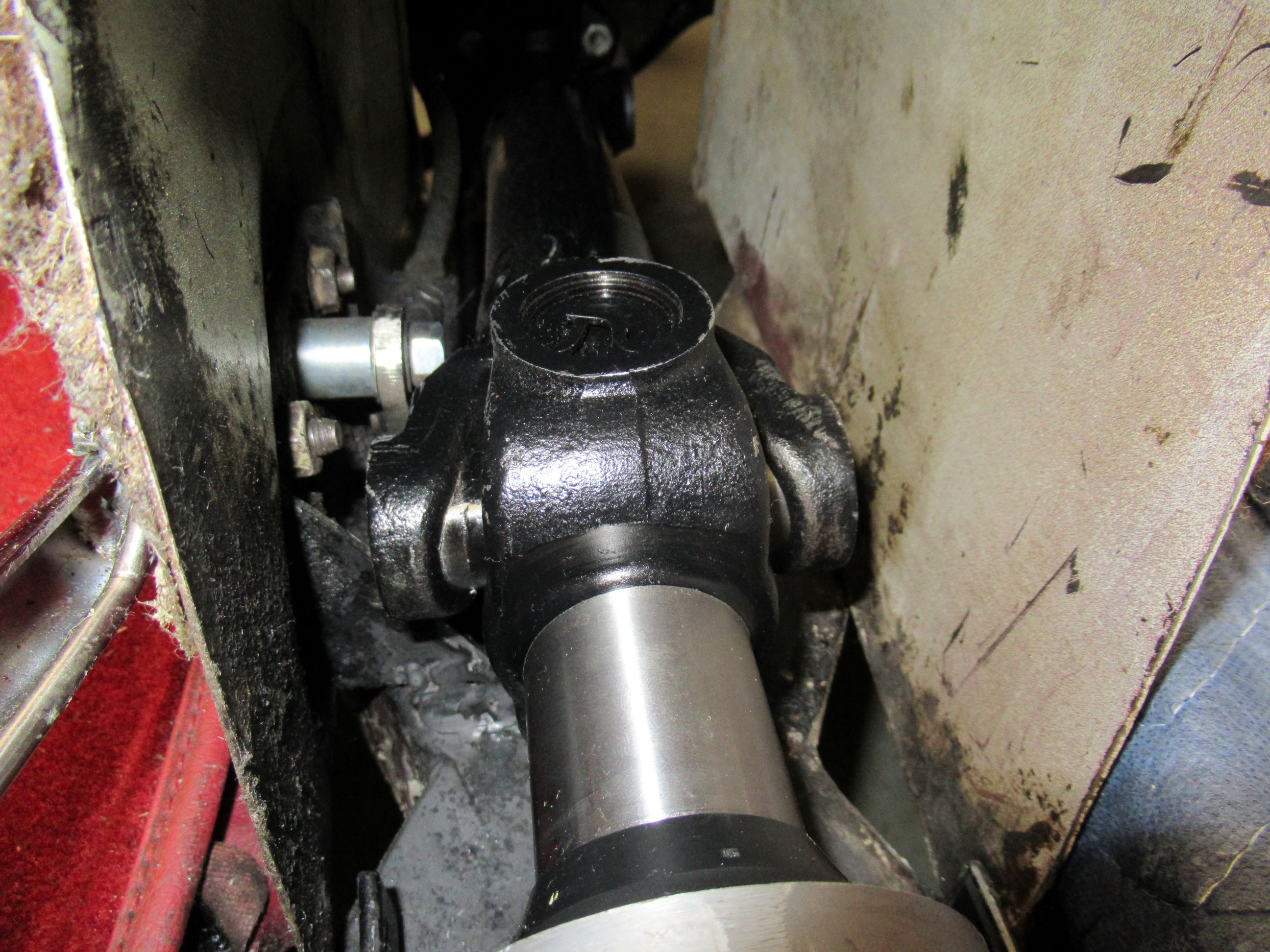

After resolving a few issues with the Mount plate and the rear mount alignment. I think we are good.

Sorry the picture is upside down .
