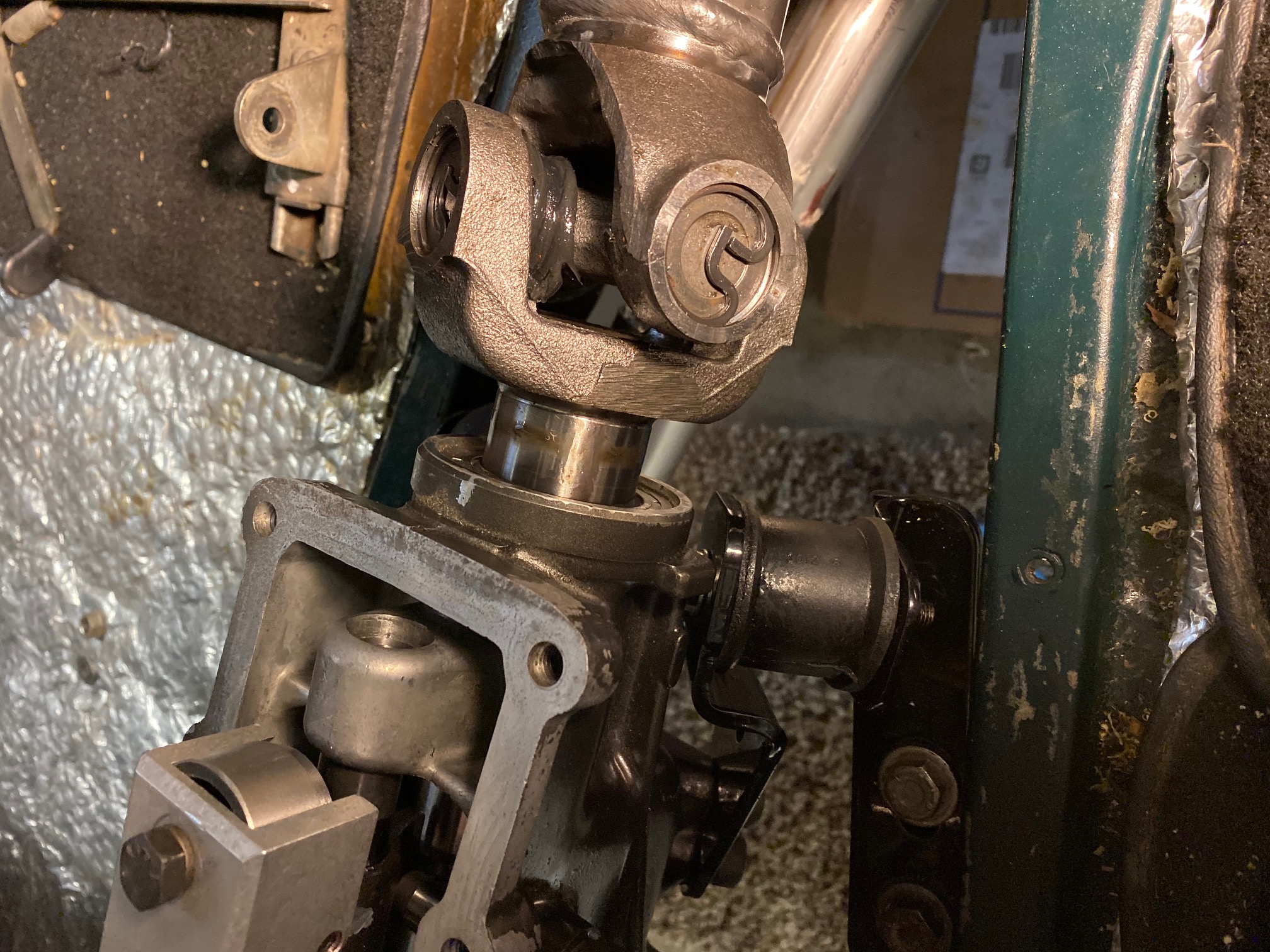

Yes. The rear of the toyota tranny is a slip in fit. So with that, one needs to stabilize the length of the TR driveshaft. What you are doing is swapping the TR self adjusting driveshaft for the self adjusting on the Toyota tranny.Charlie- Do you have the locking ring on the driveshaft?
I have the locking ring on mine.
Just wondering what you did?
Understood. I was just wondering if you cut your driveshaft to length and eliminated the locking ring.Yes. The rear of the toyota tranny is a slip in fit. So with that, one needs to stabilize the length of the TR driveshaft. What you are doing is swapping the TR self adjusting driveshaft for the self adjusting on the Toyota tranny.
Charley
Oh no, IMHO why go to all that extra work. It really never crossed my mind to cut the driveshaft.Understood. I was just wondering if you cut your driveshaft to length and eliminated the locking ring.

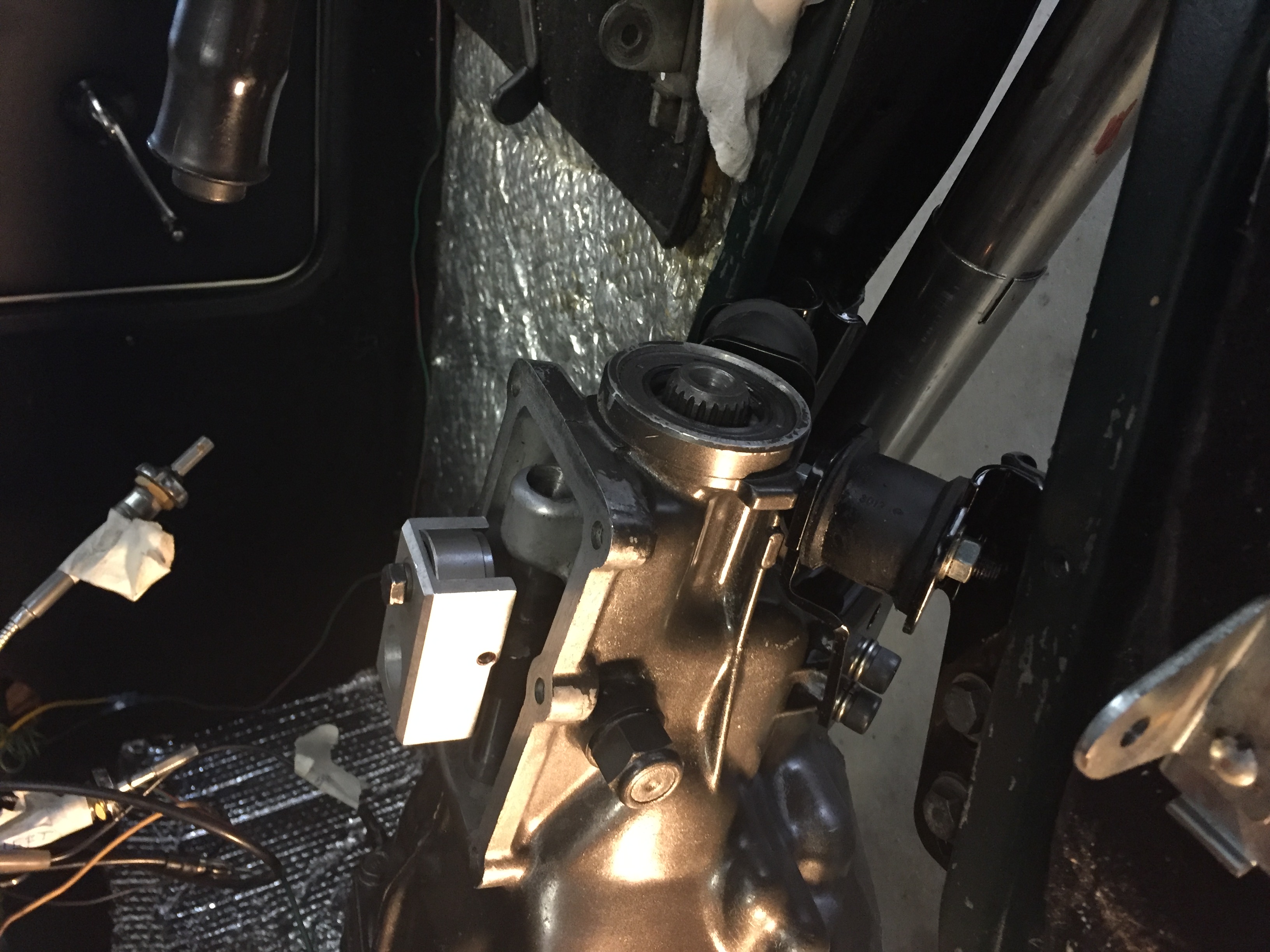

Thanks for posting those pics. I did my conversion about 6-7 years ago. I always worry about the locking ring loosening allowing the driveshaft to move.When I did my conversion I had a new driveshaft made by a local shop, using the TR yoke at one end and a Toyota slip yoke at the other end. And of course it was all balanced as a unit. Attached are some pics showing the W58 in place and the new driveshaft.
