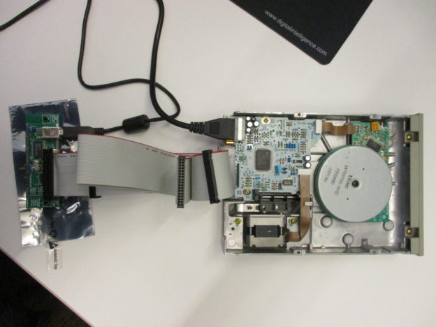

Paul - I asked the same question here a few months ago. No such animal exists.
So I built my own system, using a TEAC 5.25" drive, a USB interface, and some simple software; plugs into my Windows 10 laptop. Here's a photo:
But I'm sure Linux can do the job for you. :devilgrin:

Found out there's a floppy controller FC5025 that will convert it to a USB port, the power supply is extra, approx cost $80 for both! PJ
NutmegCT
Paul - that's the system I used. A couple caveats: the controller only works on a TEAC 360/1.2meg drive. The Windows software supplied is a bit "challenging" to use.
