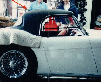

Hi Michael, I love how yours turned out. My hundred nasty boy came with a hardtop. Here's a shot when it was being completed around 1988. My hard top is now in the "to do" storage section since we set the liner on fire when we started the big V8 for the first time in 20 years and a flaming mouse nest launched itself under the top we had stashed behind the car. No worries that's why we had a fire extinguisher handy. Anyway... the plan is to get the hard top sorted down the line. I was thinking of using what appears to be a venting cutout at the top for the light (see red arrow in the photo) but I like your idea better. My top has other issues so depending on repair costs I might just get a new one. I'm in Ca. so you'd think I wouldn't use it but I love the look and want the option since I don't plan on putting the soft top back on. My best and happy racing... Janelle
