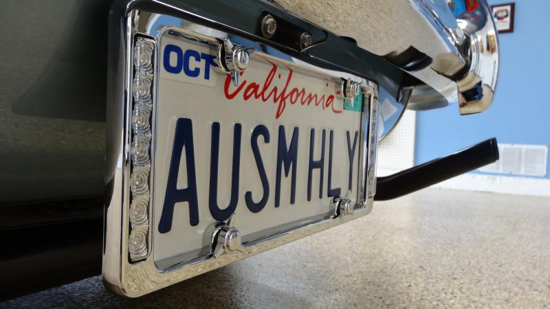

Can't beat this for easy; 3rd brake light (l.e.d.) and license plate light incorporated into the frame. Rather than to mess around with adding diodes to the original brake-light circuits (early cars with combined turn-signals/brake-lights) I simply added a second pressure switch at the 3-way (now a 4-way) block where the rear axle flex-hose connects in the hydraulic circuit. Power is tapped off the fuel pump, only a few inches away.

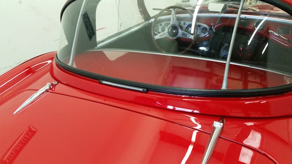

Conclusion:
I ordered the Wiipro third brake light that Jon (Roscoe) suggested
https://www.amazon.com/Wiipro-Unive...r=8-98-spons&keywords=third+brake+light&psc=1
and installed it this morning.
I attached the LED strip to the bottom of the hardtop via the 3M sticky tape that is glued to the back of the bar and after drilling a small hole in the base of the hardtop I fed the wire through base and into the boot area through one of the holes for the small chrome stay that picks up the tonneau cover and soft top bars, then into the brake light circuit.
The light bar is visually unobtrusive and the LED's are quite bright and a definite enhancement.
See thumbnails.

Jack--
I like the feel of the car with hardtop on whether good or bad weather and though I have no issues yet I really have had my dose of UV exposure and don't need more.
However if I chose to remove the top since it is so light it takes but five minutes and one person to remove/replace and it would only require cutting the two wires leading from the teed-in leads off the brake light circuit to the light. I would have used disconnects but they would be too large to pass through the hole for the stay.
