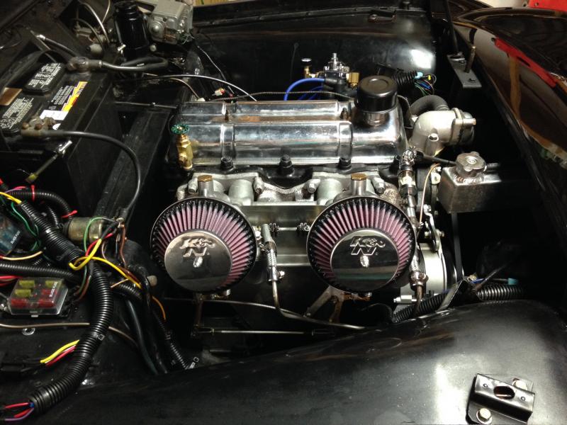

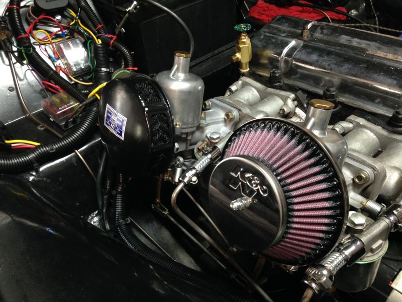

After finding a reference or two in the forum & looking at the K&N web site. I was pleased to find these SU H6 compatible cotton fibre K&N filters.
they are not offset, so my first thought was " they will not clear the float bowl".
but that was not an issue. They fit nicely & look good & though it may be my perception, seem to make the TR3A run better, with quicker starts & more responsiveness at the accelerator.

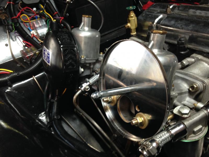

It is necessary to nut & bolt the backplate on. Rather than just bolt into a welded nut, like on the old black air filters.
attachment.php
i used 5/16"-24 x 1-1/4", though 1" would work fine.
They came with thick cork gaskets, which I like.

The new K&N appear to about triple the air intake surface area, compared to the old "rock catchers".
though I did not feel the need to enrich the fuel mix in my first test drive.

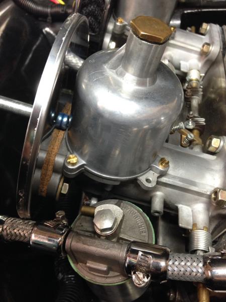

The thick cork gasket is pictured in the fourth pic. It clearly works as a spacer for the center support bolt head.
Therefore it is important not to over tighten the back plate and crush the gasket.
