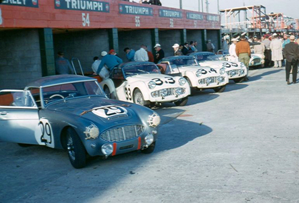

You're right, of course. When I was considering putting the strap on my car, I looked at the 100-Six race cars to see how it would look stretched over the hood scoop. Needless to say, I liked it.
I like it too, but if I was ever going to do it, I'd go with the little shorties in the leading-edge corners of the hood. As you know, it's quite a mental hurdle to drill holes into painted bodywork (though I have little reservation when it applies to paying customer's cars...)!
