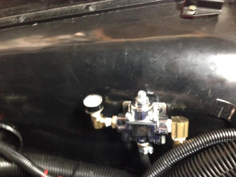

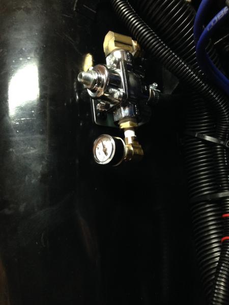

I installed a spectre 0-5 psi fuel pressure regulator to lower my airtex electric fuel pumps normal optimal pressure of approx 5.5-6psi.
it was easy to install, but because I wanted to see the gauge on a regular basis, I needed to place it inside of he engine bay.
i put it on the inside drivers side wheel well.
this required drilling 4 holes, which I wasn't crazy about.
I also added another inline clear plastic fuel filter close to forward carb. Mostly to visualize fuel flow.
The regulator certainly seemed to help overall performance.
