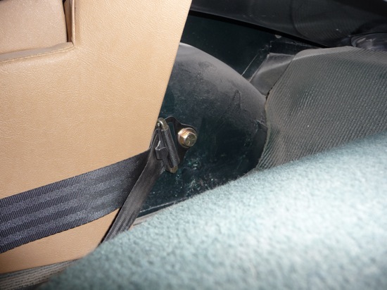

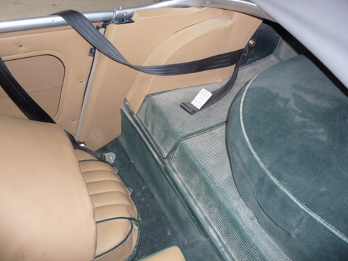

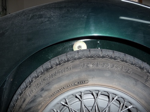

Ronzet:
I installed 3 point seat belts in my BN6.
Hope these pictures help in your drill locations.
