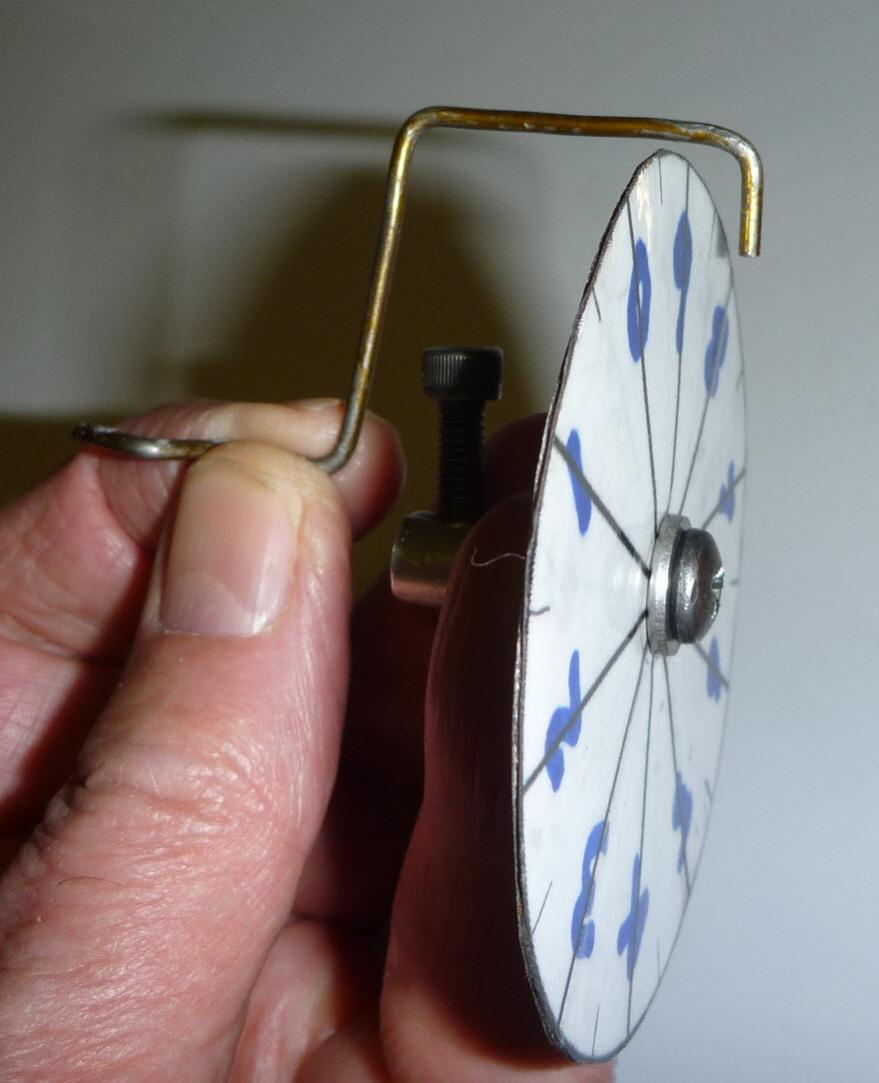

You remove the cable from the back of the speedo, attach a pointer to it, such as a piece of masking tape, push the car through 52 feet, 9-1/2" and measure the number of turns the pointer makes. This enables the speedo shop to re-calibrate your speedometer. I've used Nisonger in New York; West Valley Instruments (Morris Mintz) can do it in LA.
Nisonger has a pdf on how to do this.
