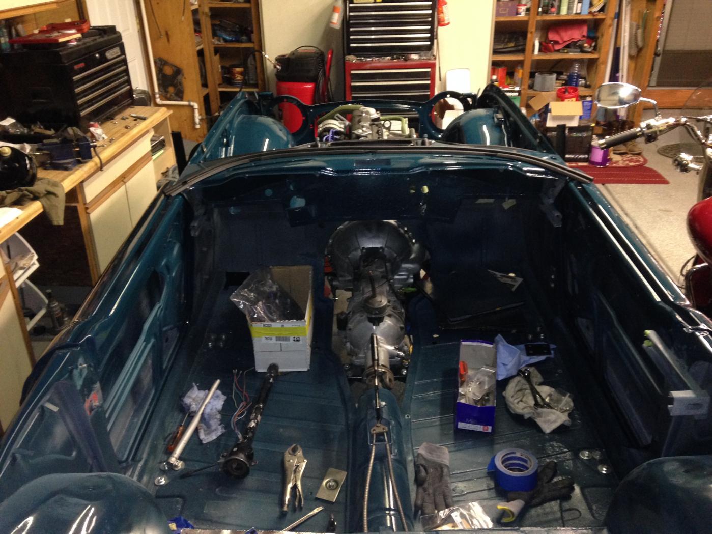

I just finished shooting the body and fenders. It is still ORANGE. Have to complete the hood and trunk lid in two days. Boy, what a hot job, wearing a bunny suit, breathing through a hood, and shooting paint. When I got done, I was soaking wet. I will let it sit till tomorrow to see how good it is. Can't tell if it is good through the mask on the hood. Seemed to go down well and I think it will polish up well.

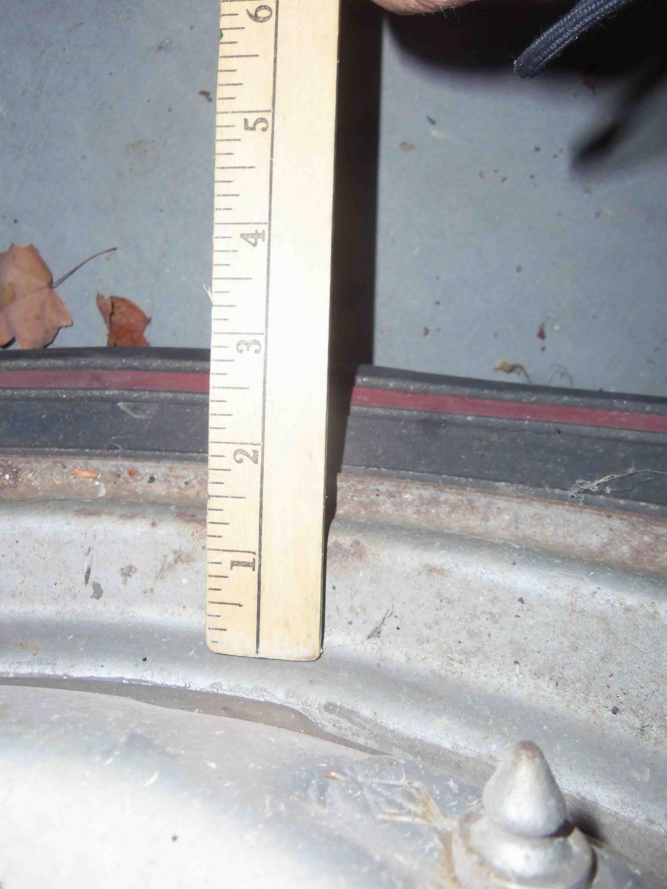

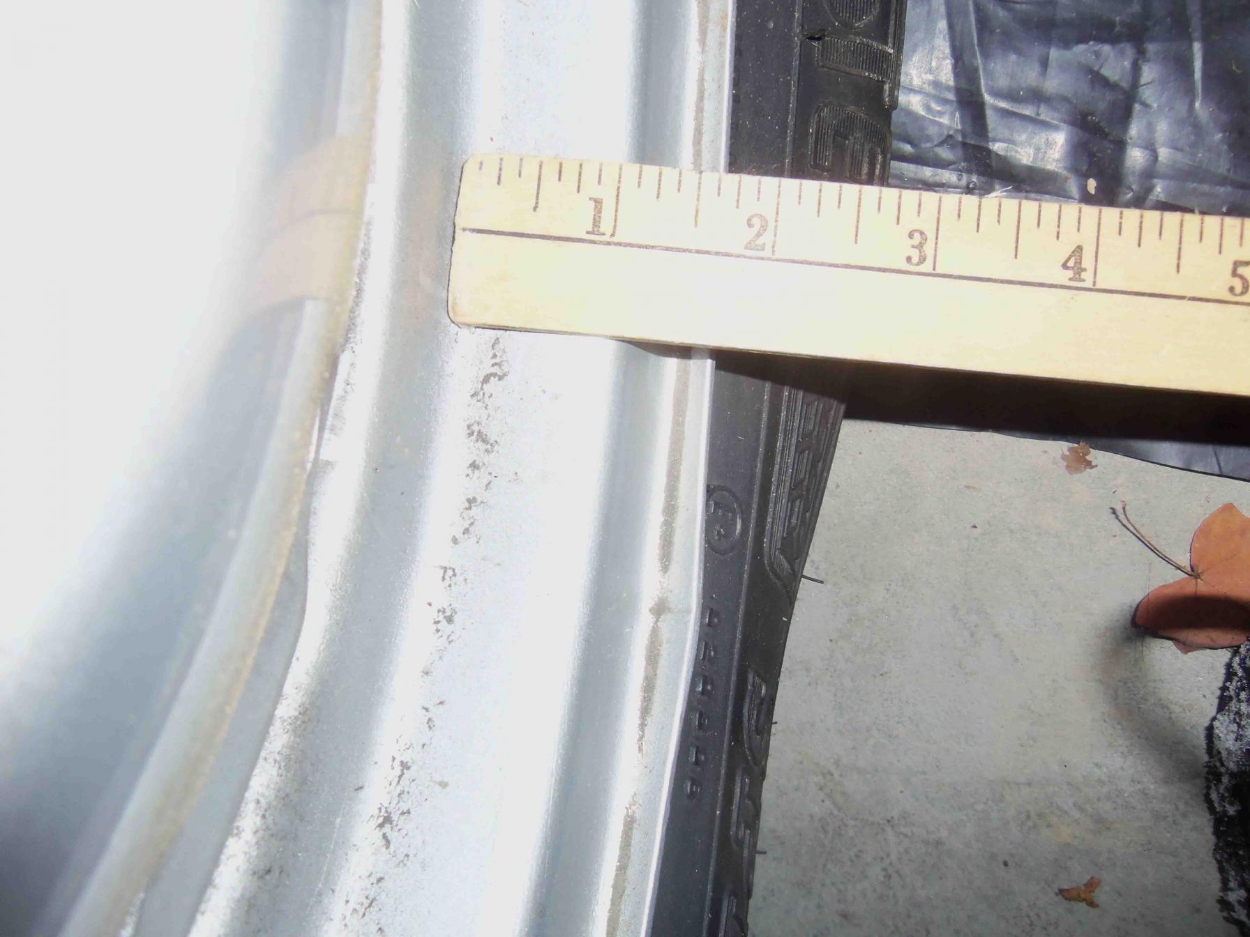

I'll trade you locations. 19 degrees yesterday and going to -1 tonight with wind chills to -10. in fact both my overhead garage doors are frozen shut and could only use the man door to get in and out. The wife was complaining about the shape of our other garage with daily drivers in it as it is hard to walk around because of all the debris around. I think it's averaged like 15 degrees since the first of the year and told her she can clean it out herself in those temps. How does the measurements look?

I pushed the car out of my paint booth and it is the best paint job I have ever done. Should polish up well. If only I had done that well 4 months ago , this car would have been done. I found just a little more reducer makes it flow better. My garage is only 64 so I left the heat on to get the metal to the right temperature. In about an hour, I will shoot the rest of the components.
I want to be done with this car so I can finish my mini!
