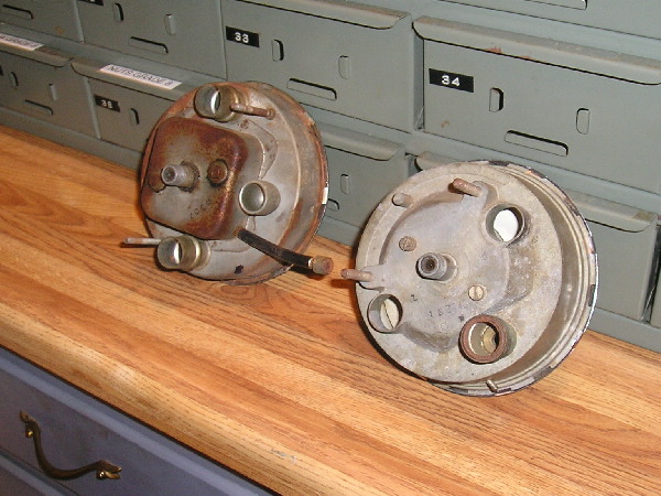

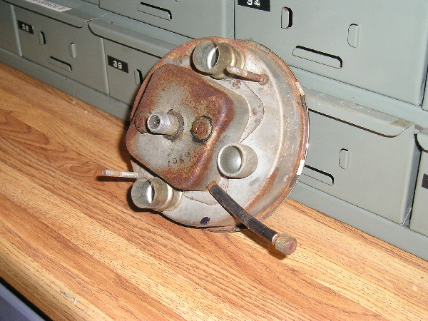

I have a couple of speedometers. I have attached two photos. One has a white metal case and one has a stamped steel case. The white metal case unit is 1 5/8" thick at the edge, the steel case is 1 1/4" thick. I suspect one is a 2-3 and the other is for a 4. Can someone ID these for me?
2nd Question, is the high beam indicator lens red or blue? Can you buy one? If it missing, and I can't buy one what do I use as a substitute?
Thanks for your help.

My early TR3A TS 27489 LO has the one made of white metal. I know that it is the original one that came with the car.
The BRG TR3A we finished last year had the sheet-metal one, but I have no idea if that is what came with the car. It's a late TR3A TS 81551 L. I remember that we had a lot of trouble to get the re-set push-rod to line up with the hole in the dash. We had to modify the innards as well as file a slotted hole in the sheet-metal case.
Measure the distance from the back of the chrome bezel to the centerline of the re-set push-rod and go with the one that fits. Or install it in the dash and see if the re-set rod lines up with the hole in the bottom flange of your dash.

There was (I think) a lot of variation in the speedos, even among the 3s & 4s. For accuracy of course the important thing is that 4 digit number on the face as that is the number of times the cable should turn in a mile.
I have seen red, green and blue hi-beam jewels... possibly blue or red for TR3 & green for TR4 but these units get swapped around pretty freely so I rally can't say based on what I've seen.

In the "for what its worth" department the steel case one has a totally different spacing on the mounting screws. So it will not fit the 3 dash plate anyway. Would still like to know what it goes to though.
