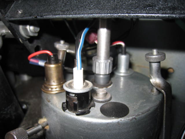

I found the stock 2.2 watt bulb doesn't light up the entire gauge enough. An Led does a much better job, however the light is blueish.
What seems to work well is to install another bulb in the bottom of the gauge. Two 2.2 watt incandescant bulbs fill up the gauge and keeps the off white/yellowish tint.
Here's a photo of back of the speedometer. The top of the gauge shows the factory bulb holder has red/white wire. I added another 2.2 watt bulb in the bottom. That holder is brass, with a red wire which was spliced into the top red/white wire.

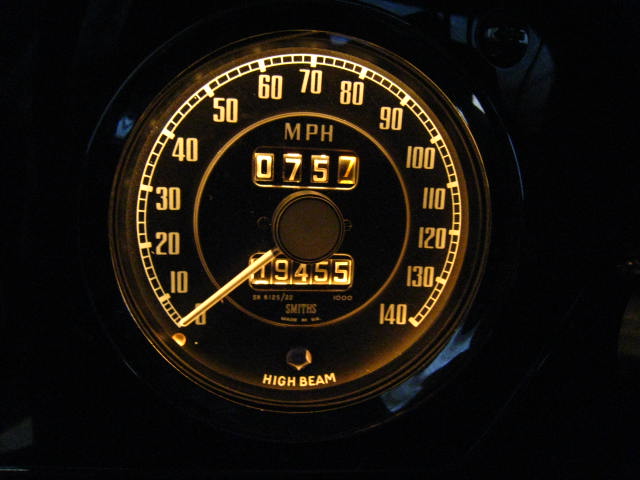

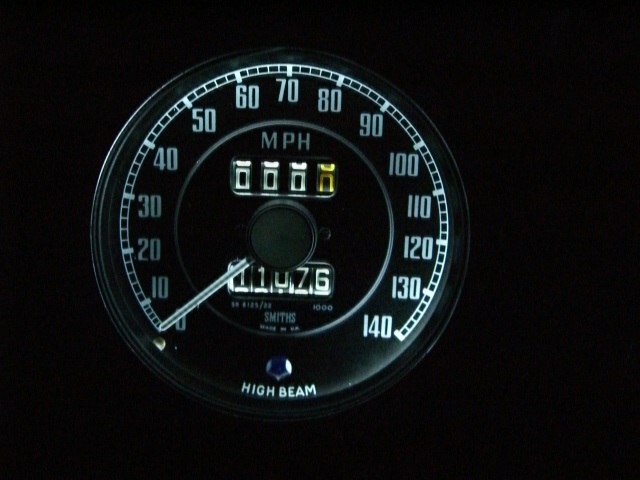

First photo is two 2.2 watt incandescent bulbs.
Second photo, two 1 watt LED bulbs.
Cheers,
Roger

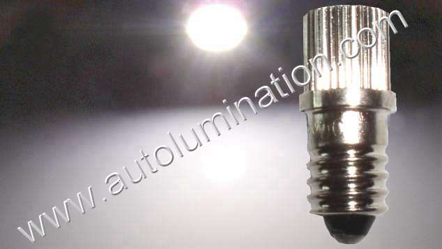

Hi gelmon,
Have you tried the LED bulb I referenced in my article. Photo of the led bulb from their site below.
Most led's pinpoint their beam forward, whereas that one, radiates about 180. It's really bright, doesn't get hot, screws right in and it's a lot safer than an 8 watt fillament.
I run these led's in my directional's. Nice to be able to see them flash in daylight.
I run two 2.2 watts in my large gauges and single 4 watt's in my two small gauges. I prefer the original off white shade of ilumination.
