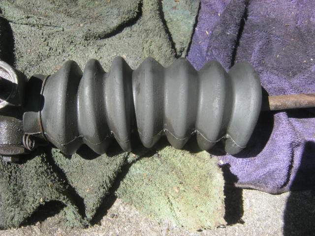

I have just removed the steering rack for service.
Boots are original, 44 years old.
I was thinking replace just because.... yet... them seem perfect.
No marks, cracks, and still very elastic... is this a case where the originals are better then what is available new?
Just put them back on? they are inexpensive, that is not the issue, just wondering about quality...
Any one have any insight?

My guess is that those 44 year-old boots have a better chance of surviving another 20 years than a set of new boots. But that is just a guess.
BTW - I think the boots on my TR4 are 56 years old and they are still fine.
I agree. Use the originals if possible.

Gentlemen, Thank you very much. I will use the originals.

The boots are probably not original, if they are in such good condition, but that really doesn't matter. They are probably way better than what you can get today. The rubber used today is absolute garbage. The manufacturers have to know that, but keep pushing parts with rubber that doesn't last a year.

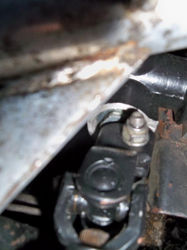

Lower steering column universal: I removed to clean, maybe paint and discovered a serious "catch" in one of the axis, feels munched... yet is still tight. The ones I see on-line do not look as robust as the one on the car (sorry I forgot to take a pic).
Comments? Moss at least looks cast, RF seems to have a stamped plate component... (it is currently soaking in varsol, and my fingers are crossed it will free up.

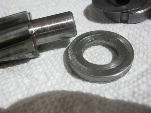

Opinion pls:
The Pinion, there is virtually no wear on the lower thrust washer.
The top thrust washer has significant wear.
The thrust washers do not appear to be available.
Re assemble as is: 0.010" play in pinion, book says 0.010" max
Invert thrust washer and re assemble: 0.003" play.
I expect the warn pinion not matching the new flat surface will quickly 'wear into' the trust washer and there will be more clearance/play....
So....
1) Assemble with the washer inverted? (0.003"... may quickly become more)
2) Order and wait for a 0.005" shim and assemble as is?
Currently leaning towards inverting the thrust washer.
opinions appreciated...
thanks, Stephen

-Steering gear Pinion, Have ordered shims, will mount warn to warn to max surface area.

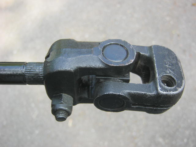

Want to see the TRF U-joint installed.....nothing puny about it.TR6 Steering shaft U-joint 001.jpgTR6 Steering shaft U-joint 001.jpg

Thanks, I will have to call them and ask.... I see both RF and Moss use the same Exploded Graphic... it lead me astray...
Yet I see a picture of the one like yours on the Moss Item, perhaps it is the same one RF sells, I will call then and ask, thanks.
(Hate to have to replace mine, is so solid and tight, just has a nasty 'click' which of course is a sign of things to come.)
I take it that it is sturdy?

That's just a drawing !
Yeah, I'd call the real thing sturdy...good enough for me.
Poolboy, the saga.... ordered from Moss.... was stuck in LA post office for 5 weeks. Found one at a supplier here in Canada, hour drive... picked it up and low and behold original!
Installed and done...
of course the Moss part arrived the next day.... returned.
