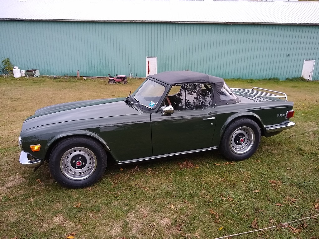

I have an early (Dec 69) 1969 TR6 that I am trying to get back to original. I am amazed so far about all the differences between the 69 and the other years. I am currently working in the engine compartment and was wondering if the original car had a shroud in front of the radiator or behind the fan? Any idea? I have the yellow striped hoses, and both a silver and chromed rocker cover (still trying to decide which is correct there as well). Where would be a good source of information on original 1969 make-up?

Looking at the picture you have attached, you have the correct 12 hole wheels, 5 1/2 x 15 with the stubs for mounting the ROSTYLE hubcaps. Don't knock those stubs off, if you are ever lucky enough to find a set of the ROSTYLE hubcaps, you'll need those stubs. Later wheels had 15 holes and no stubs since they used the small center caps like you have fitted.

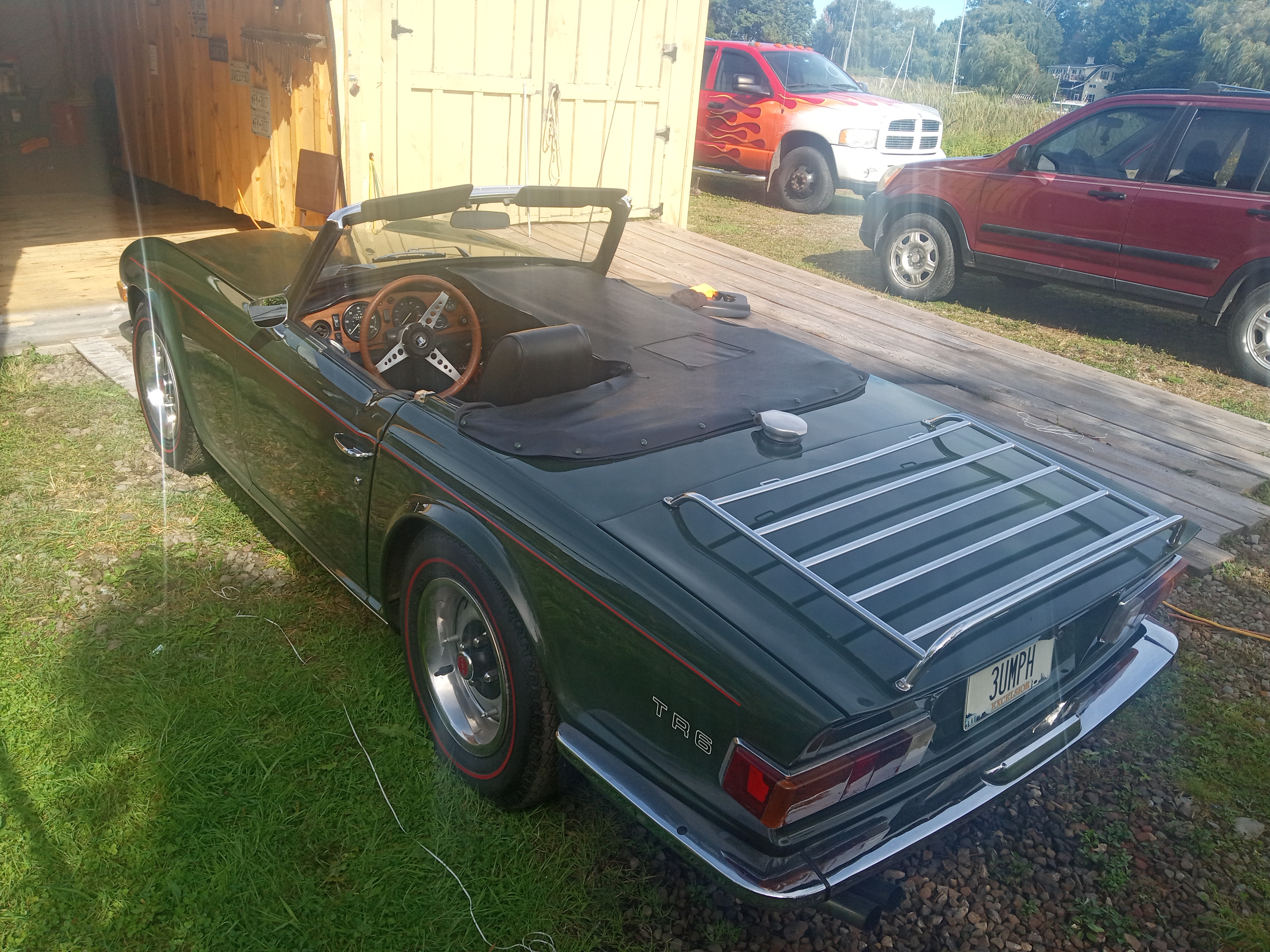

I am also looking for the 4 lug rostyle wheels for my car. Any idea on a location? Added to that, is my steering wheel and hub. Even though they are the earlier ones with the holes, they are not black. We're all 69 steering wheels/hubs satin black?

Unlike several years of MGBs and MG Midgets which did use Rostyle wheels, the TR250 and 1969 TR6 did not use Rostyle wheels, they used Rostyle hubcaps which were mounted to the stubs on the wheels mentioned in my earlier post. You have the correct wheels, you just need to find the Rostyle hubcaps. Unfortunately that is easier said than done, but every now and then some show up fleabay or in Hemmings, here in the classified section, etc. One odd thing, at least in my mind about those hubcaps, they are stamped in a way that they show five "lug nuts" even though the cars use four studs and lug nuts per wheel.
Regarding the steering wheel, the spokes should be black on the 1969 TR6 although given some of the stuff I have seen, it would not shock me to find out that very late production 1969 cars were fitted with later silver spoke steering wheels. If your car's production date is say August of 1969, that may be the case, it it was May though, it has had a later steering wheel fitted at some time along the way. What I seem to recall is that it was an black anodized finish (a black dye was added during the sealing step for the anodized layer). This isn't something you can easily do at home. If you can find a black matte finish paint, especially if it is an epoxy paint for better wear resistance, that is something you can do at home and most would be none the wiser.
OK, My TR6 has the three posts to mount the Rostyle hub caps and four lug nuts. I found some paint for the steering wheel and the hub behind it and painted them. It looks OK. The five lugs on the hub caps has me confused. I thought that the hubcap fitted over the existing lug nuts. But if I am actually looking for a hubcap with five fake lug nuts, it explains why I have never seen one with four. The search continues.

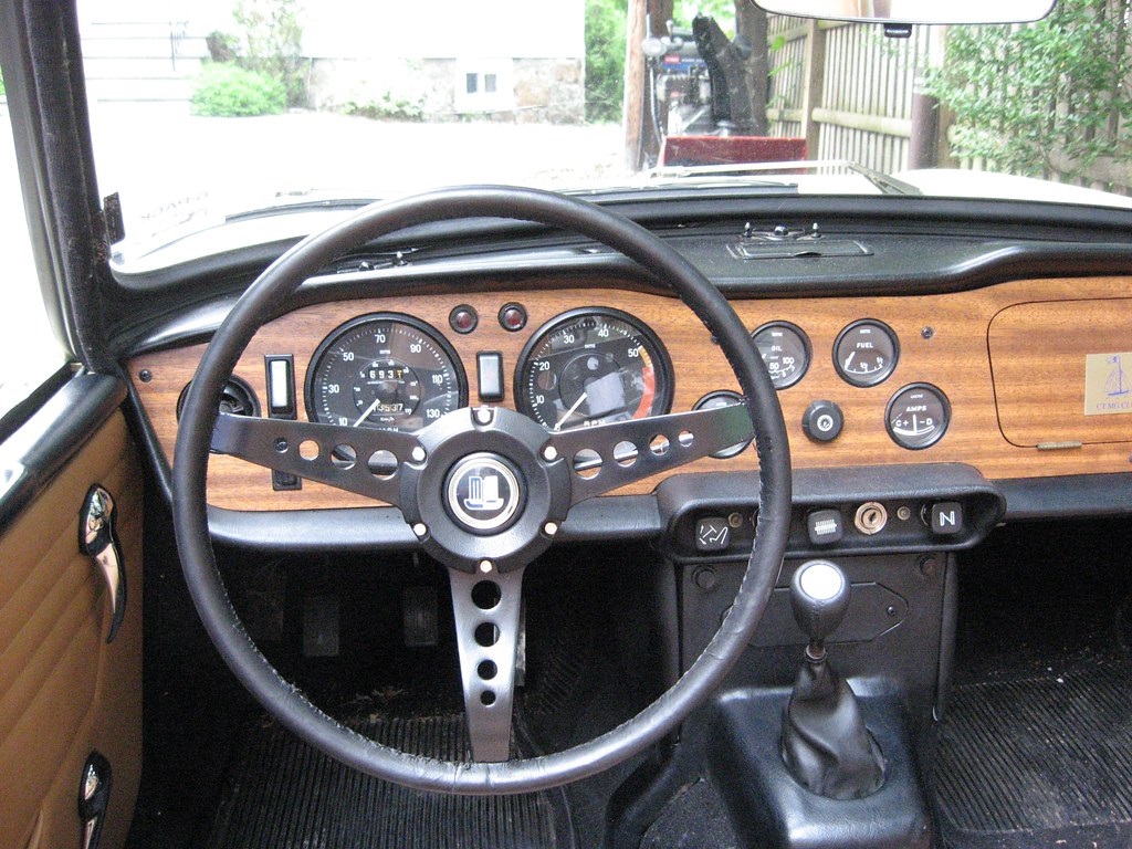

Next question. The gear shift knob for my November 68 build 69 was leather covered with a metal 1-4 and R on top in silver? Or was it wood with the griffon/open book logo in black and white, or was it griffon/open book logo in white and blue? wood or leather trim?

Bolded was standard fitment for North American market cars. The wood or leather with the open book Triumph logo would be popular aftermarket items with the majority being from AMCO. AMCO made shift knobs for all manner of cars with logos or with shift patterns. They also made consoles, floor mats and other interior accessories along with luggage racks, bumper bars, mirrors and such for the exterior. They were sold by most dealers to the point that first BMC and then later carried over into the BL days, they became "factory authorized" and were carried under the BMC style "HAC xxxx" series of part numbers regardless of which BL brand was the target audience.
