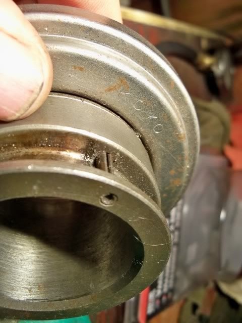

That might be the Throw Out Bearing itself spinning on the fork.
If so an anti rotation pin would stop the rotation and the noise.

The release bearing would make noise when pushed, not released. There is a slight chance that mis-adjustment could cause noise, like Ken said.
