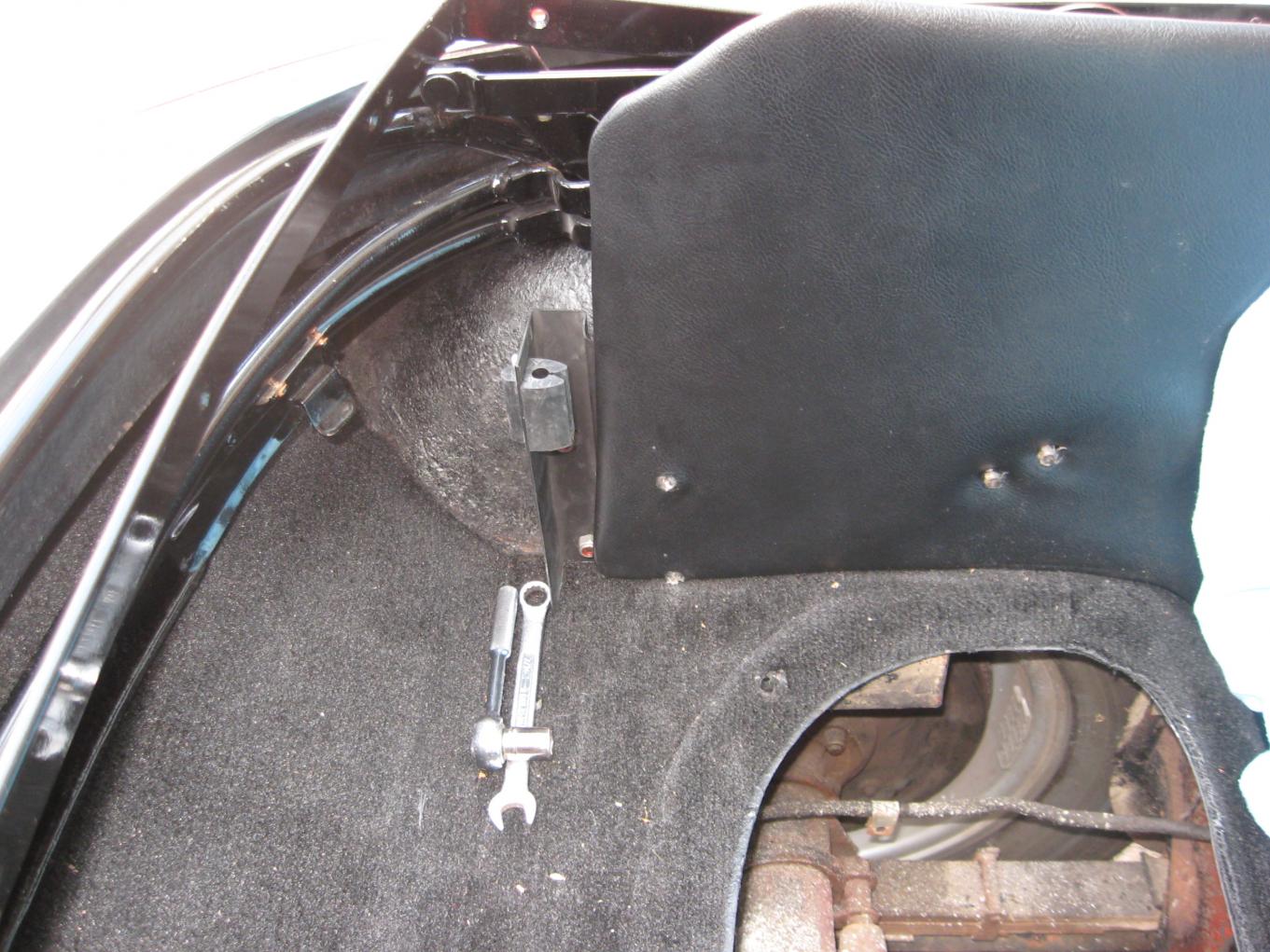

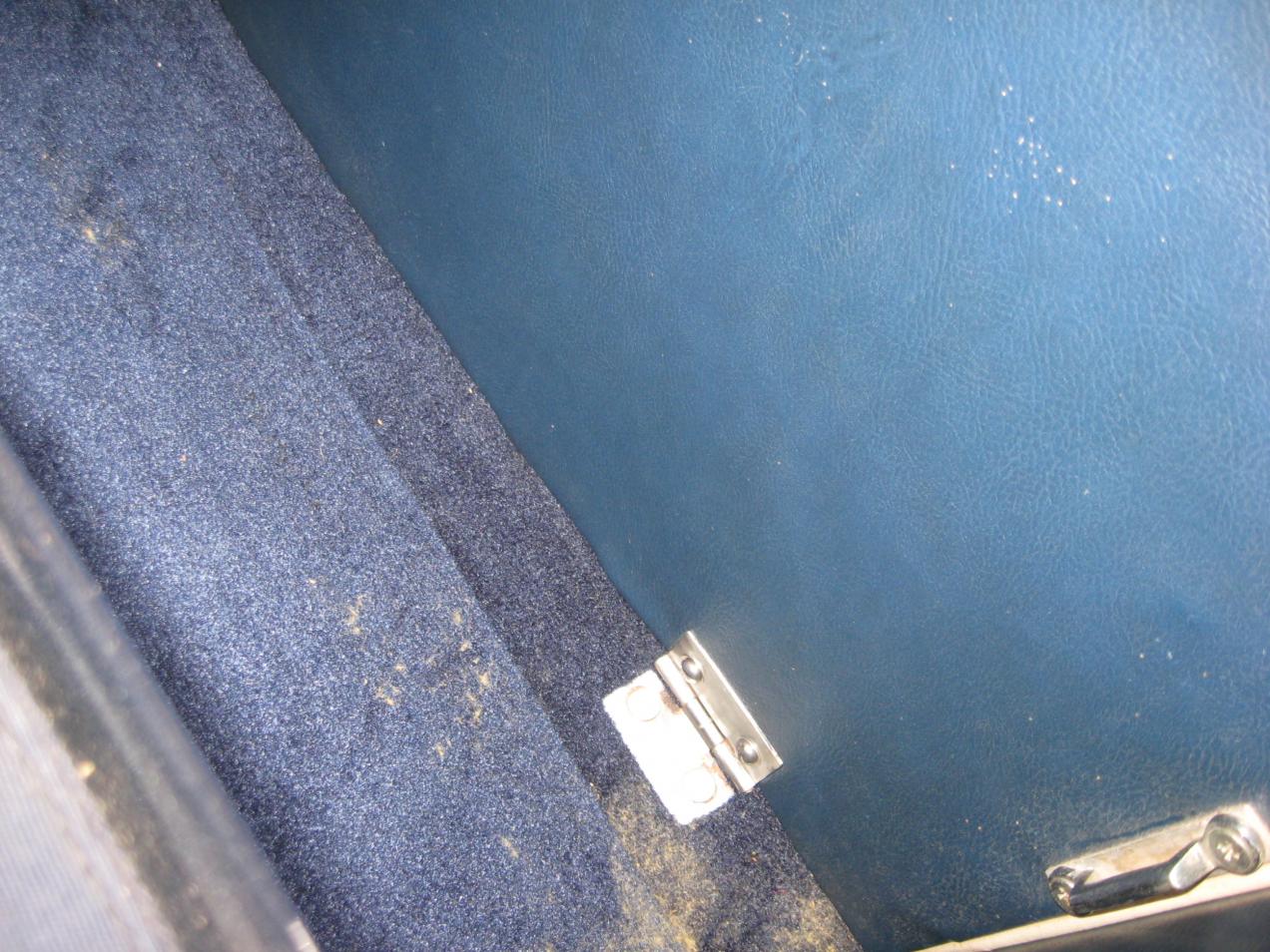

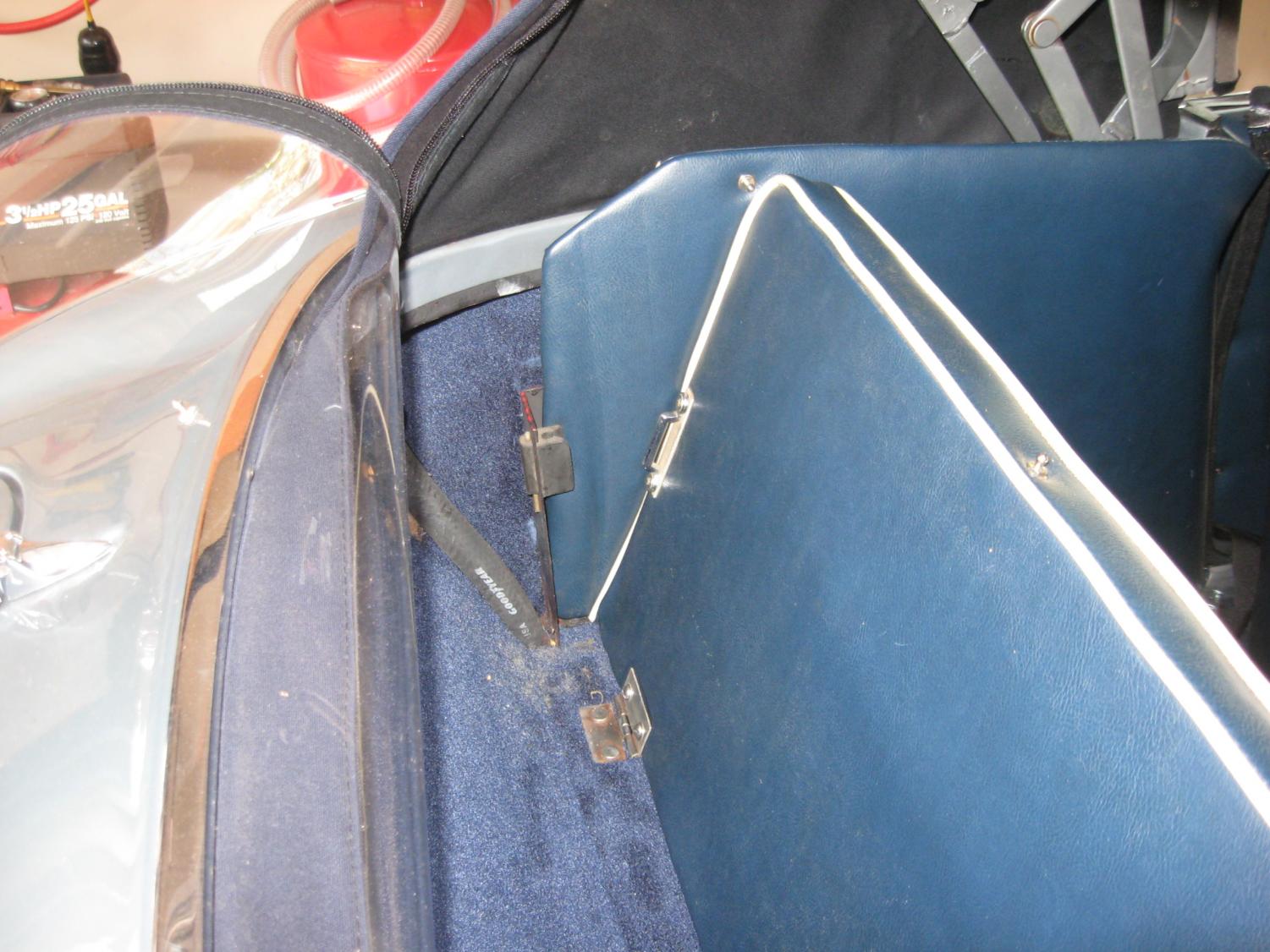

i visited with tproject this morning and took several pictures and measurements. bob hughes are you saying that the holding brackets for the squab are on top of the vinyl quarter panel trim. the car i looked at this morning had the brackets behind the vinyl trim. could you please confirm again? if tproject does not care i can post a couple of pics of the squab mounting and hinges for future reference. below is a picture of how i think the squab holding bracket is mounted. if i use the holes that you see in the vinyl trim the squab sits too far forwaed. and, unless i mount the brackets on top of the vinyl trim the trim will not clear the ninety degree frange that the rubber holding piece is attached to! the previous owner had mounted a carpet covered board in place of the squab and brackets...so i think that those vinyl trim holes are wrong if used as a guide for the squab mounts????
