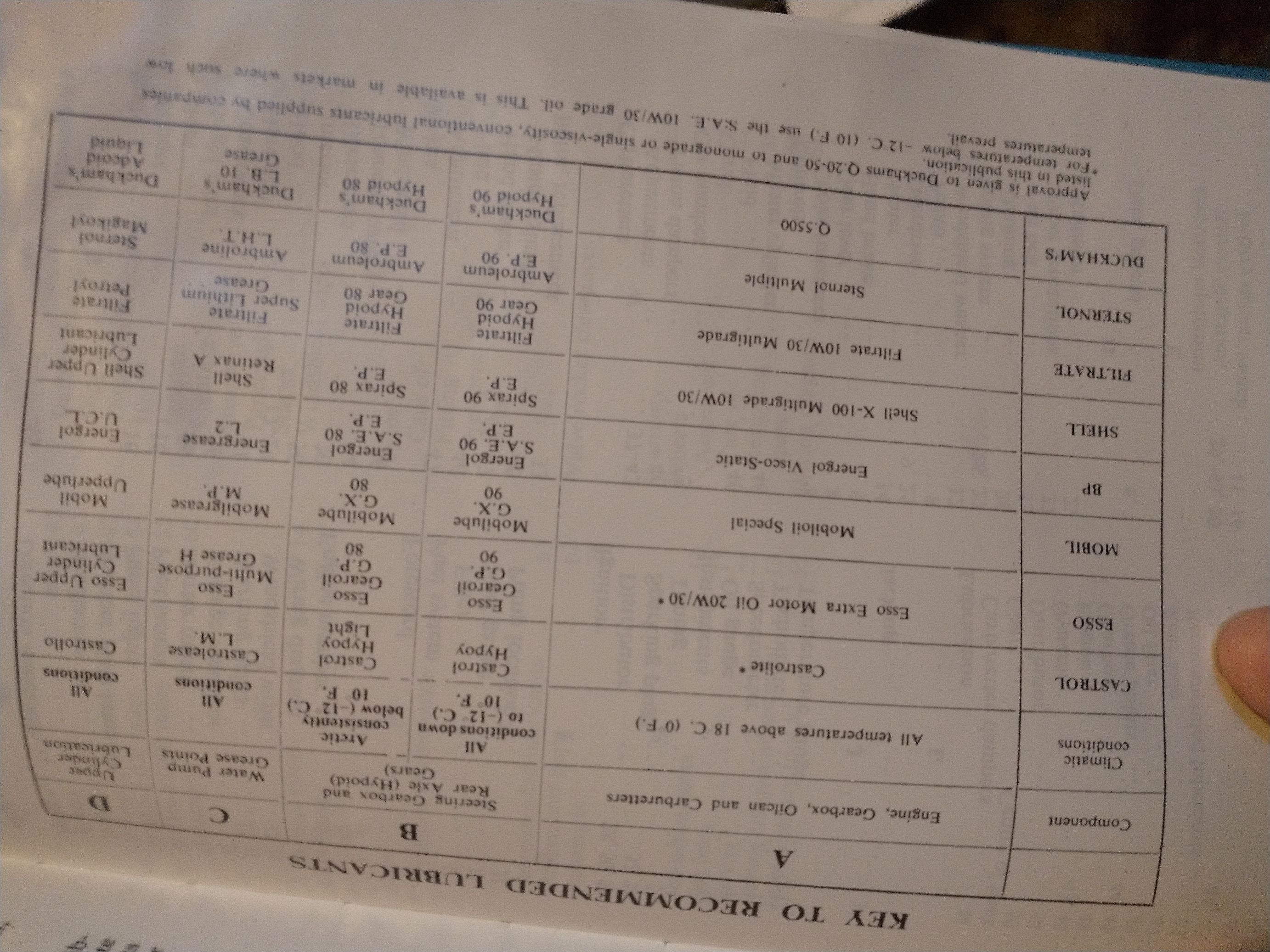

3000 MKSI and MKSII. The manual says 10W-30 and 20W-30. At the bottom Duckham's Q-5500 which is 20W-30. The foot note, Approval is given to Duckham's 20-50. I understand in certain circumstance's the 20W-50 can be used, maybe in hot weather or racing conditions, but using 20W-30 for everyday driving isn't going to blow up your engine.
Looks like the Driver’s Manual and the Workshop Manual disagree. The Workshop Manual says 20W-50. That’s where I, and others, base our opinions.
Kodpkd, do it!! Run 10-30 in the summer. Teach us all a lesson.
Meanwhile, by the time they published the 3000 MKIII handbook they provided breakdowns for three climate conditions. For temps above 41 degrees F 20-50 seems to be right.
