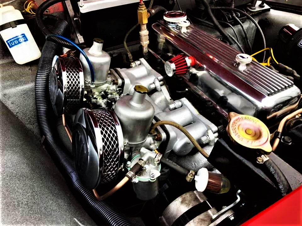

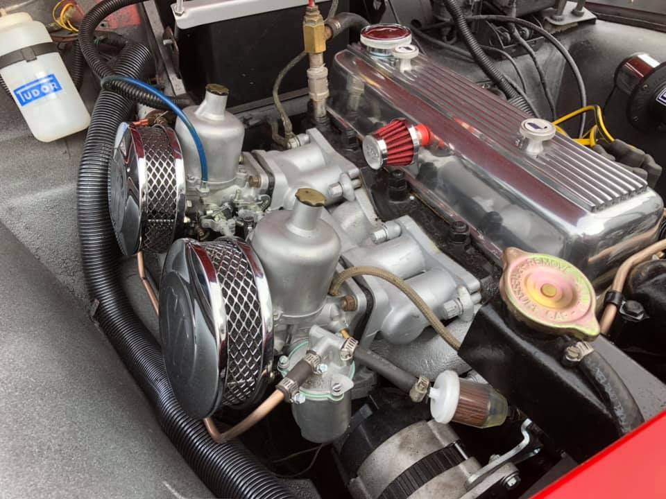

I have a 1960 TR3a with a TR4 engine,
I am about to change the fuel pump,
any tips would be appreciated...
seems the steering column may be in the way,
or do I need to do the replacement from the bottom up?

I've always replaced them from the top. The aft retaining nut can be a challenge. I have a "special wrench' that helps with that. Just make sure the cam follower rests on top of the cam.
On my 1961 TR3 I cut the corner off the steering column bracket so I could get my fuel pump on. And I go in from the top. I use "flex" socket extension.
It sounds like the support bracket for the two piece steering column presents obstacles that the single piece column does not. Mine is a single piece column but I have replaced one on my friends car and its a two piece without cutting anything. I remember it was a challenge, hence my special wrench, but still doable.
A 1/4 in wobble with a short 13mm socket, on a 3 inch extension.Doubt if I have done
more than 50 over the years. Dont even start if you do not have these tools in hand.....
